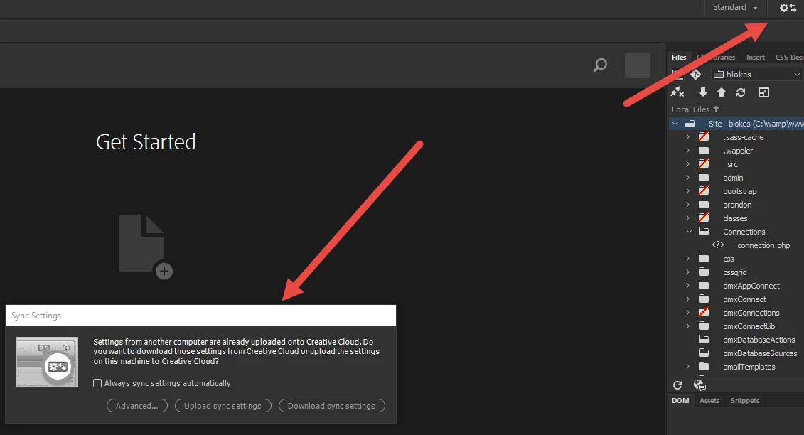

I updated to DW 2018 and wanted to apply the settings from the previous version. The only way to that is by syncing with prefs from the old version. After installing nothing happened about initiating that process, so I started sync. Then a dialog came up (after about 10 min!) telling me there was data from a previous version, so I clicked the button to download that sync data. Nothing happened except the spinning blue circle for another 10 min, then the little blue sync arrows appeared on the sync icon at the top right. I waited over two hours and nothing changed. I closed and restarted DW and tried re-syncing. It froze and I needed to force quit. Tried again, and the same again. I signed out and signed back into CC and I uninstalled and reinstalled DW, and started all over again and the same thing happened again as described at the beginning. DW 2018 is broken.

    lnayal​ posted this on the Pre-release Forum:
    Please delete the existing folders/entries for 19.0 listed below and relaunch DW CC Next - Sites should be migrated.
    Win:
    Registry - HKEY_CURRENT_USER\Software\Adobe\Common\19.0
    Explorer - %AppData%\Roaming\Adobe\Common\19.0
    Delete DW CC Next preferences ( https://helpx.adobe.com/dreamweaver/kb/restore-preferences-dreamweaver.html )
    Mac:
    ~/Library/Application Support/Adobe/Common/19.0
    ~/Library/Preferences/Adobe Dreamweaver CC Next Prefs
    Delete DW CC Next preferences (https://helpx.adobe.com/dreamweaver/kb/restore-preferences-dreamweaver.html)
    If you do the same by substituting 18.0 for 19.0, I think that you will get the following scenario when you re-start Dreamweaver
    Once you have clicked Download sync settings, the 2 arrows in the top right hand corner will turn blue symbolising that it is in the process of syncing. This will take some time depending on the internet connection.
