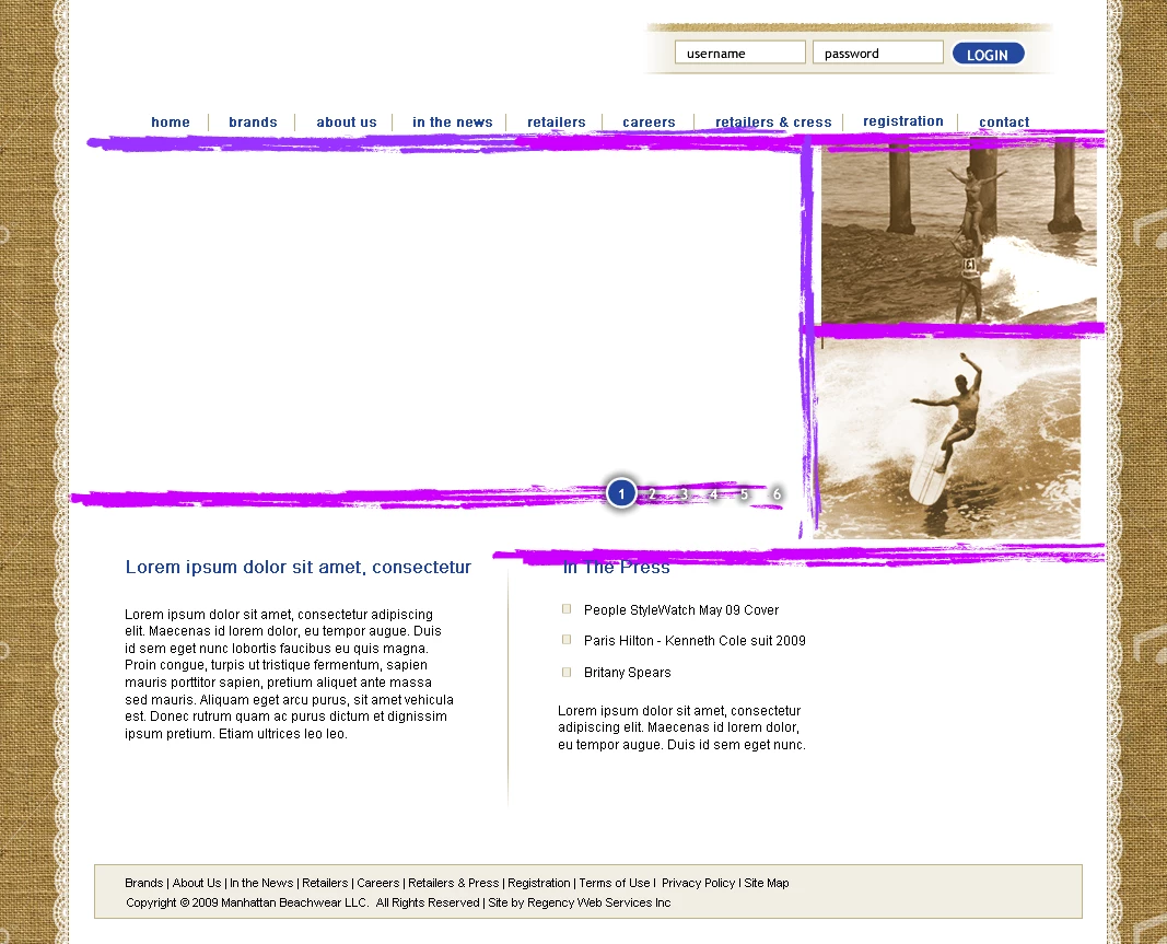

    Sep 30, 2009 4:12 AM UTC
    Sarthak,
    Attached is the file that has the Illustrator Artistic Brush strokes that were imported into Fireworks CS4.  This file saves at the normal rate in CS3, but takes a long time (up to two minutes) in Fireworks CS4.  Please help me to understand the problem.
    Natalya
    Sarthak Singhal
    Oct 5, 2009 6:55 AM UTC
    Natalya,
    I worked with the 4 MB png file you have sent and the observations are different at my end with experiements on a Vista and Leopard platforms. The time taken at my end is in the range of 5-10 sec with CS3 and CS4.

    Sep 27, 2009 7:56 PM UTC
    Sarthak,
    Attached is the file I am having problems with. The components that are
    causing the problem are Illustrator Artistic Brush strokes that I imported
    into Fireworks CS4 form Illustrator CS4. These components have been
    highlighted in purple. CS3 does not have any issues with this. Is there a
    patch or work around for this?
    This file will take 60 seconds to save in CS4 versus 3 seconds to save in
    CS3.
    Please help me.
