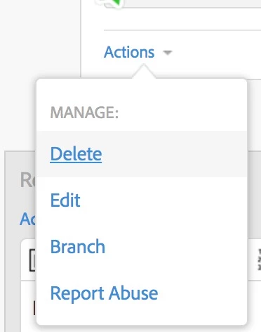

    I'm sorry you're having difficulty posting/editing your post.  Posts are indeed editable.  To edit the main post click on the 'Edit' link to the right of the post, in the Actions menu:
    To edit follow-up posts click on the Actions menu below the post and then Edit:
