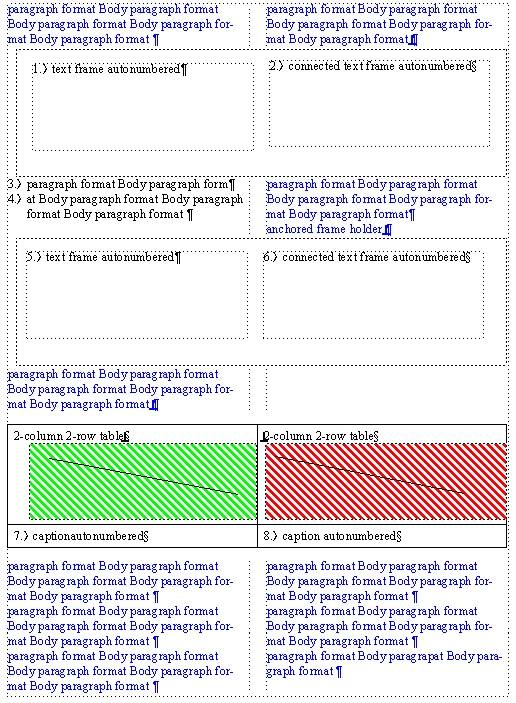

  • Earlier you mentioned that the captions in connected text frames within anchored frames both appear under the first graphic; the start in new frame property handles this, though it's an additional paragraph format that needs to be applied to these rare special cases.
    Here are a couple of experiments with a two-column text frame that may be helpful, or may just retravel your old roads. The body paragraph format is in-column. Across-column behavior comes from anchored frames or tables in either left or right columns. The autonumbering is maintained from within connected text frames in an anchored frame, through main text, and into table cells.
    HTH
    What version, dialog and tab is that in?
    I see it nowhere in the FM7.0p578 I run at home.
    And I ran the connect-the-frames test. It does indeed fix the auto-number problem.
