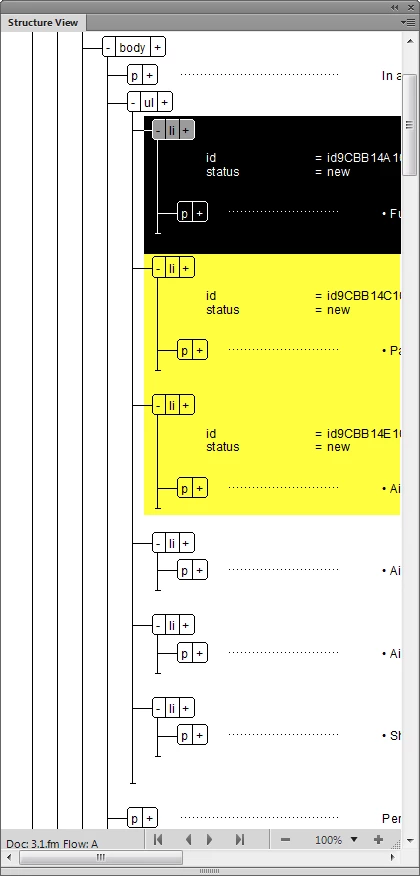

Add an Element to an ElementRange
Here is a screenshot to illustrate my question:
I have an ElementRange as illustrated by the selection in the screenshot. I need to add the two follow li elements to the ElementRange because they have the same status attribute value ("new"). Give an ElementRange, how do I add the next sibling element to the ElementRange? I am content with adding them one at a time, if necessary. I have some ideas and will post some code, but I am trying to get a head-start by asking here. Thank you very much.

OK, let me restate my task. Given any element with a particular status attribute value, I want to make an element range containing all of the following consecutive elements with the same status attribute value. First, to isolate the elements that are the first element in a series of sibling elements (or the first with no ancestors), I am using this xpath statement with FrameSLT:
//*[@status="new"][not(ancestor::*[@status="new"])][not(preceding-sibling::*[1][@status="new"])]
This makes sure that I don't process any elements that have ancestors with the same value, or elements that have immediate preceding sibling elements with the same value. For each of these elements, I will get the appropriate range by using the code below. NOTE: For the code below, I am testing with the "first" element being the currently selected element in the document. In the finished script, I will loop through the elements returned by the xpath statement above.
