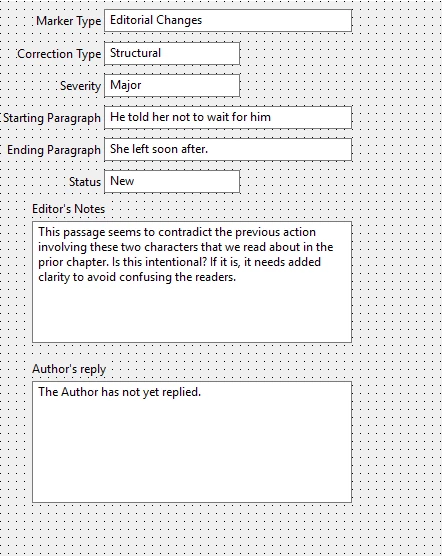

Adding fields to a custom marker
A typical marker window looks like this:
Can I create a custom marker with a window that would like more like the below? Please ignore the grid; this image is a mocked-up marker type done outside of Framemaker.
I'm using FM 12 by the way.
Arnis Gubins
Nov 16, 2016 2:30 AM UTC
This probably could be done using Extendscript or Framescript to create a custom solution. However, it wouldn't be a trivial exercise. If you're comfortable with scripting, you could try to do it yourself [help available in the FM Scripting Forum]. Otherwise, you could contact Rick Quatro (aka "frameexpert") at Carmen Publishing Inc.  for potential help.

Thanks, Arnis,
  I've begun working on this. I'm a developer so coding is no issues. I've figured out how to build the form. I need a bit of help to figure out how to capture the user event when the user requests to create a marker of the specific type so that my form shows up and not the standard form, stuff like that. Nothing that the scripting guys should not be able to handle.
