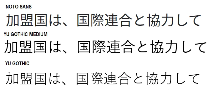

Feb 17, 2023 6:21 PM UTC
I just played around with some fonts, and Yu Gothic Medium (which is available in FM) looks to be very close to Noto Sans JP (it has upward 'brushstrokes/flairs' on bottom of the straight lines for は and に, etc., just like Noto Sans). See the attachment.
