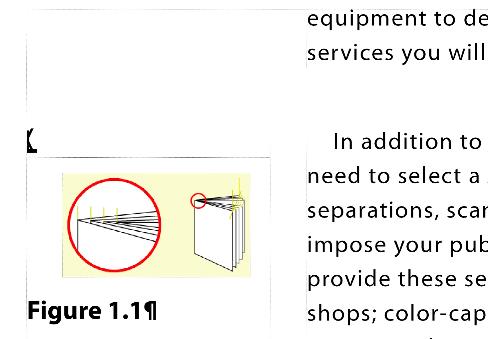

Barb Binder
Nov 5, 2018 2:45 PM UTC
Hi Doug:
Is what I'm showing what you are looking for? If so, try this:
  1. Click at the end of a paragraph.
  2. Press Enter to create a new ¶.
  3. Anchor the image (below) to that empty ¶.
  4. Assign a paragraph tag to the same ¶ that moves it and the image into the sidehead, to the left of the paragraph that follows it.
  5. Click at the end of the same ¶, press Shift+Enter for a line break and then add the caption.
~Barb
