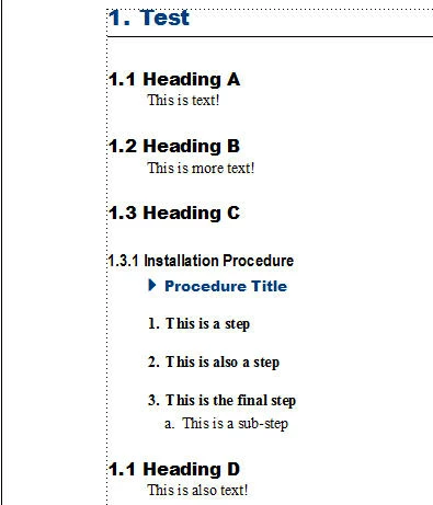

I'm running into a strange issue with headings that are autonumbered. Everything works as expected... until I include a proccedure that has autonumbered steps and sub-steps. The heading immediately following the procedure renumbers from the beginning. The image below shows an example. There are three headings, which are numbered correctly. Then I inserted a subheading with a procedure and the heading below it has incorrect numbering. This only happens in headings that follow a procedure.
The autonumbers for the paragraphs are:
Heading1: <$chapnum>.<n+>
Heading2: <$chapnum>.<n>.<n+>
Numbered: S:<n+>/\t
NumberedCont1 (sub-step): <a=1>.\t
Is there something incorrectly set up in the autonumber format or is this a bug?

Take a look at this. http://help.adobe.com/en_US/FrameMaker/9.0/Using/WSF176D8C8-8133-4860-88E3-AF69262623F0.html
The problem is in this paragraph with this numbering:
You reset the numbering of the main paragraph back to 1, when you used the <a=1> tag since you did not preface it with S:.

You probably wanted something like S: <>.<a=1>
July 29, 2013
Thanks Michael! That worked!!
