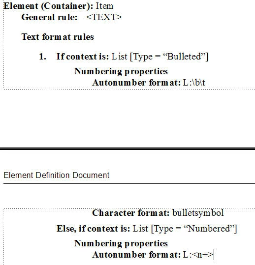

I am trying to create a numbered list element, that will restart at 1 each time it is used.  The User Guide says "By default, each counter is initially set to zero. The counter can maintain its current value, be incremented by 1, or be reset to a different value. For example, use <n=1> in the format that resets numbering to 1 at the beginning of a new set of numbered steps."
So, I've built my EDD like this:
But when I import the EDD to test in a document, each list continues the numbering of the one before it. I've tried playing around with the syntax, but it's new to me and I can't figure it out.  How do I set it up so that each list starts with 1?
Here's an example of what I get (sorry it's ugly, I'm following advice and getting the structure set up before I do the pretty formatting!)
Thanks!
Correct answer Van Kurtz
First, when you have several lists, as well as numbered tables and figures, it is best to use a different series label for each type of list.This is especially important when you have lists inside lists and you want the numbering to change from say numbers to letters to roman numerals, etc. So, I would replace the L: in the Bulleted list format to something else, say B:. In fact, you can probably leave it out, because there is no distinction visually between the first bullet and the second, and the first bullet in the next list.
Second, I am not so sure that you can use <n+> in the autonumber format and expect it to restart at 1 with each new list. I believe the phrase "intially set to zero" means at the beginning of the document. You need to add a subrule inside the numbered list context that checks for the FIRST item element in the list element, and then set its number to L:<n=1>. This is how I do it (just a cut and paste from my EDD):

Moxamoll
MoxamollAuthor
December 2, 2010
I thought that somehow I needed to nest an "If/Else" within an "If/Else", but I couldn't figure out how. Subrules!
Thank you!
