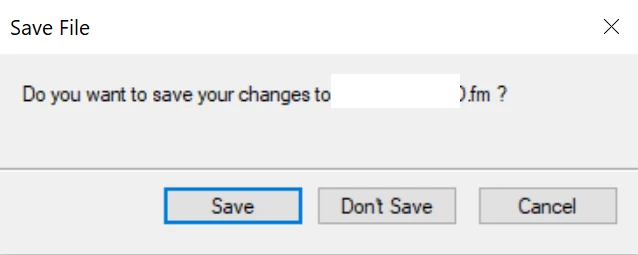

To cut to the chase (this has taken me many hours), the symptom is that after the process to add or remove line numbers was performed, when clicking the X to close the document, FrameMaker displayed a Save File dialog, even although the document had been saved by the code. Saving manually via File->Save also made no difference.

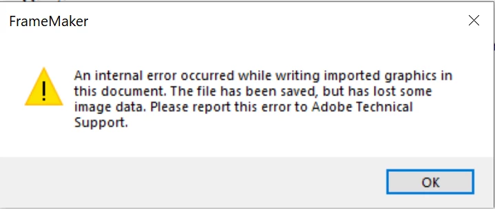

After clicking Save FrameMaker showed the following dialog.
After clicking OK FrameMaker showed the first dialog.
Clicking Don't Save would allow the document to be closed. Sometimes the document when opened, woudl not have the line numbering on or off as expected. I also expect that the loss of other changes was related to subsequent processing, where the code has very little error checking, so would continue, if the FDK calls returned errors.

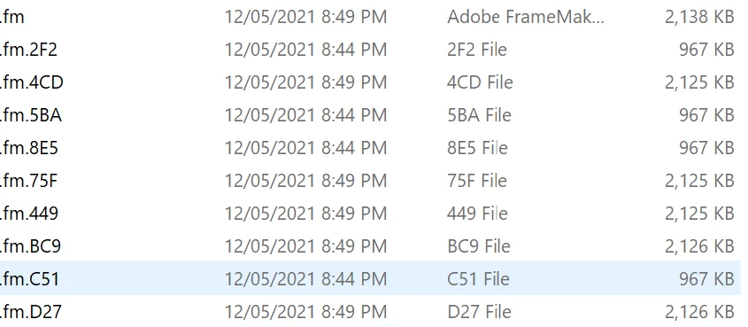

The other symptom is the presence of temporary or intermediate files as shown below. How many there were seemed to influence whether changes were lost.

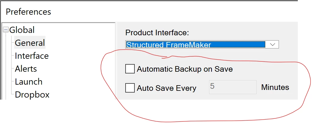

With changing the preferences are you referring to either Automatic Backup on Save or Auto Save?
With these checked FrameMaker creates a *.backup.fm or a *.auto.fm. These are not what this bug creates. These preferences are not used in my customers environment as any saves, CTRL+s for example, are automatically sent to the back end CMS system, and any processes that change documents also save automatically.
If I rename one of the temp/intermediate files, created by the bug, and open it in FrameMaker I see a copy of the original document at various stages of the line numbering process.
