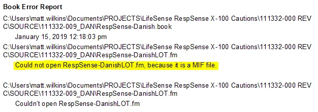

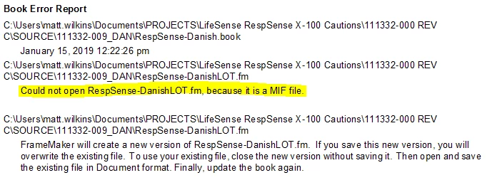

When attempting to Update a book or "Save as PDF" I get the error messages below:
When Saving as PDF:
When Updating Book:
I get an error report, but also the windows prompt error, and FM randomly creates separate TOC/LOF/LOT files unstructured.
