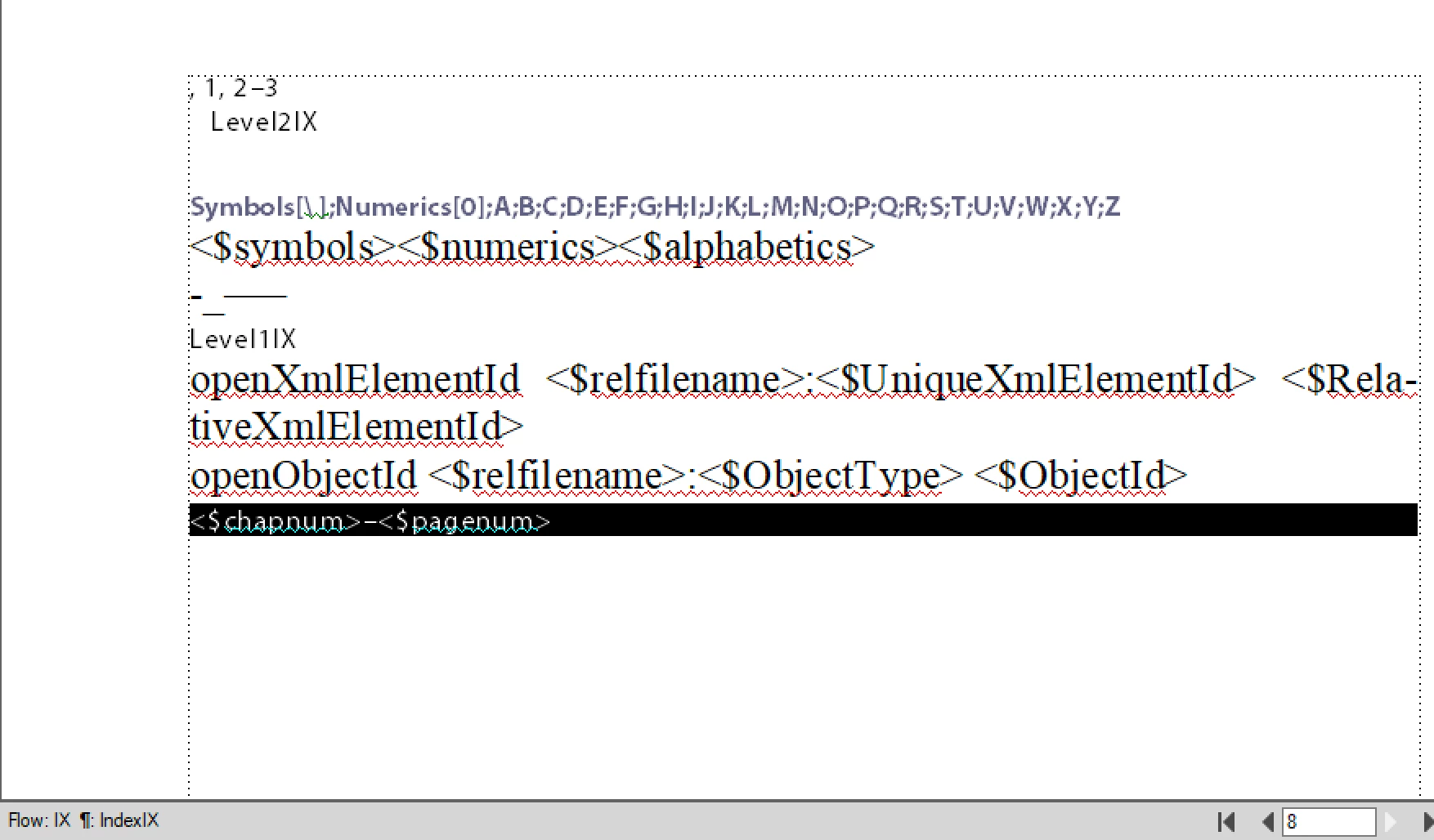

    The first thing I found is that your <$pagenum>-<$chapnum> paragraph was not using the expected tag name. The ¶ tag name should be IndexIX and your is ActiveIX. I added the tag to the document and assigned it to your paragraph. (This might have fixed itself after you address the second issue, but I worked through your files in this order so I'm not sure.)
    This is a different index, showing the correct tag name in the lower left corner.

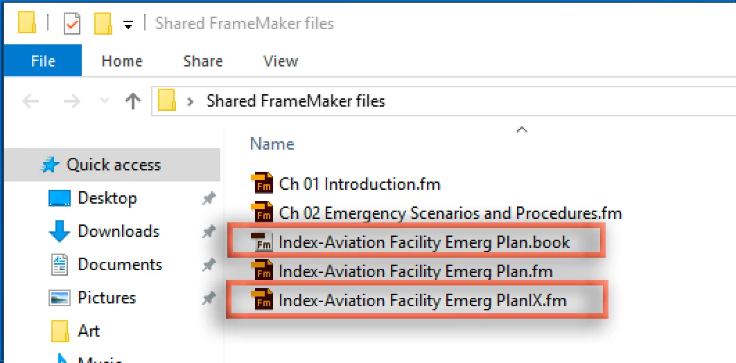

    The second, larger issue was that the index you sent was not a generated file that could be updated by FrameMaker. Generated files end in the suffix for that type of generated file: a generated index must match the book name and use the IX suffix.
    These are the files you sent:

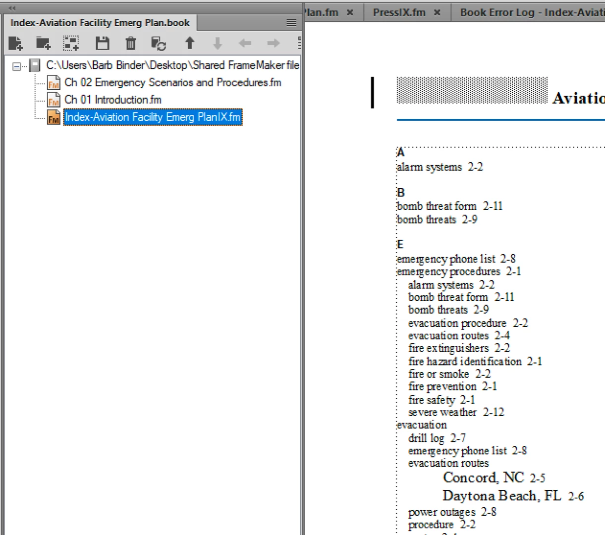

    Here are the files after I created a book file, removed your non-generated index and added it back into the book via Add >
    Standard Index.
    If the book name is Index-Aviation Facility Emerg Plan.book, then the index must be named Index-Aviation Facility Emerg PlanIX.fm. FrameMaker does this for you when you add the index to the book window through the Add menu.
    Since your book that likely does not use that exact name:
    1. In FrameMaker, remove the index from your book window.
    2. In Windows, rename your index to match the book name plus IX.fm (booknameIX.fm)
    3. In FrameMaker, add the index back into the book via Add > Standard Index
    4. Update the book and the numbers will update:

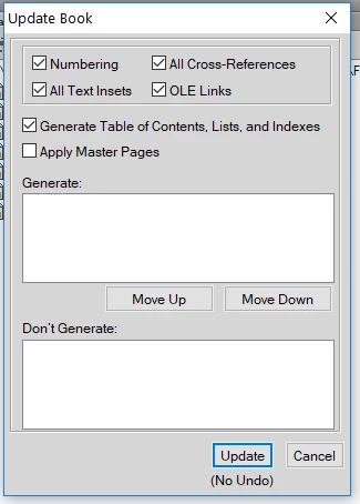

    The MasterPage mapping error is a red herring. It means you enabled the Apply Master Pages checkbox in the Update Book dialog box. Just uncheck it.

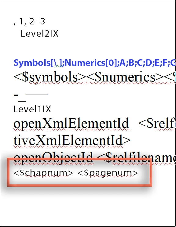

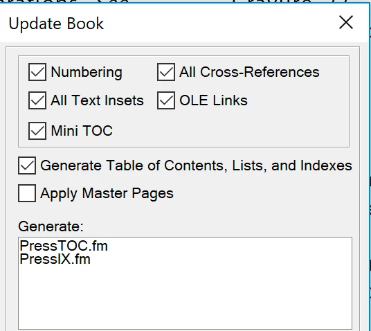

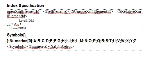

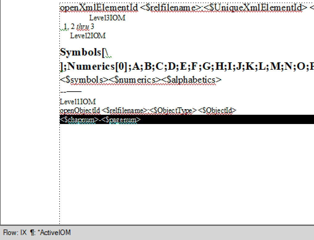

    Here is what's strange... the "Apply Master Pages" box was not check marked. I did notice that in the Generate box, it doesn't show the filenames that I am using for the TOC and IX. It's blank. The Index Specification reference page is spanning to two pages (likely because the info doesn't fit in the box on the first page so it created a second page itself. At the bottom of the second page it shows the <$chapnum>-<$pagenum>. I have no idea why it did it this way after I had it import formats from another document. See screen shot below.

    Are you still getting the master page mapping message with the checkbox off?
    You can consolidate the IOM building blocks by control clicking on the frame on the first IOM page and making it larger. Then you can delete the overflow reference page.
