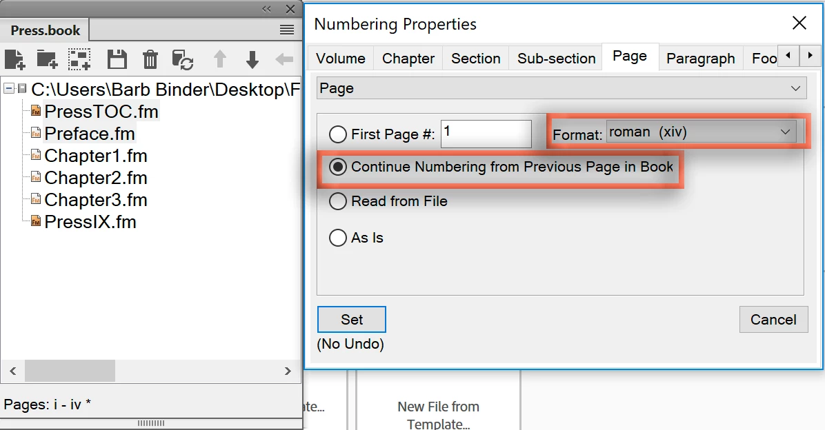

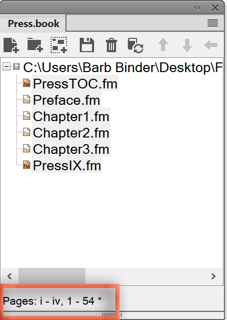

    Sep 28, 2018 12:47 AM UTC
    Hi framemaker_user:
    Did you get it to work? I have always had problems (well, for the last 20 years or so) trying to update the radio button options on the left, and changing the Format from the drop down list at the same time. At this point, I tend to change one of them (i.e., Continue numbering from Prev Page in Book) and choose Set (which updates the book) and then return and change the format (i.e., to Roman) and then click Set again (which updates the book again). I have seen the other chapters decide to update themselves so I follow the same procedure to get them back on track.
    Remember that you can select multiple files at once, and then change them at the same time.
    It may take me a few extra steps, but it does always work.
    ~Barb
    Sep 28, 2018 6:24 AM UTC
    Glad to hear I'm not the only one! I have concluded that the Numbering properties dialogue can only handle one change at a time, and requires the softly-softly, iterative approach Barb mentions  ;-}
    Sep 28, 2018 6:41 AM UTC
    Thanks all for your responses. Yes, agreed, it is good to know not the only one. I'm new to Frame, and good to know.
    I get it to work. I set the chapters appropriately re numbers (3 chapters). Then I set the numeric pagination for the chapters. Works great. Then I set the numeric pagination for the front matter with roman numerals. Works great.
    Then I update book.....and it all reverts back. At this point it feels like a bug - I've tried it numerous times now. FM 13 (2015). Can't figure out why update book causes it to revert back. Will sleep on it and review again.
    Many thanks to all the responses. New to Frame, this is definitely a great forum.
