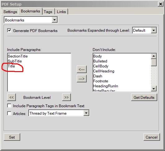

    I'm using paragraph tags to make the bookmarks.

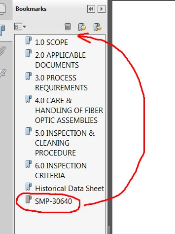

    Problem is, when I go to the PDF Setup dialog box and move them over to the "Include Paragraphs" column, it always wants to keep them in alphabetical order.  One of my paragraph tags is "Title" which happens to be toward the bottom of the alphabet so it's always at the bottom of the list.  That means my Title book mark is always at the bottom of the bookmarks in Acrobat, but I want it to be at the top of the list of bookmarks in Acrobat because it's in the beginning of the document.
    Is there a better way to set the bookmarks?

    So, it's not the level of the bookmarks that I'm having problems with, it's the sequence.  "SMP-30640" is the title of my document, so I'd like it to be at the top of the list of bookmarks.  But it always ends up at the bottom because "Title" comes, alphabetically, after "Section..." or "Sub..."
