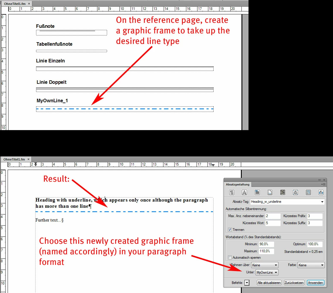

    Also - I can't use the Below Paragraph selection for under the Header and use Single Line. I tried that, but I have multiple rows (between 2 -3) running headers on each page, and when I use that, it underlines each one individually.

    UPDATE: Looks like the only way to do this  - please correct if mistaken - is to draw a line using graphics tool. If this is correct, aside from using the ruler and eyeballing it, is there any way to ensure its completely centered?

    You've been looking in the wrong place to add a line style to be used below paragraphs. These lines need to go to the reference page (there are already the frames for the single and the double line). The steps one by one:
    • Go to the reference page and draw a graphic frame (using the corresponding tool). Name it as desired.
    • Within that frame, draw the line you want to have below your heading, and adjust the parameters as needed.
    • Go back to the working pages, and define the paragraph format to use the newly created frame below the paragraph.
    • Done.
    I hope this helps.
