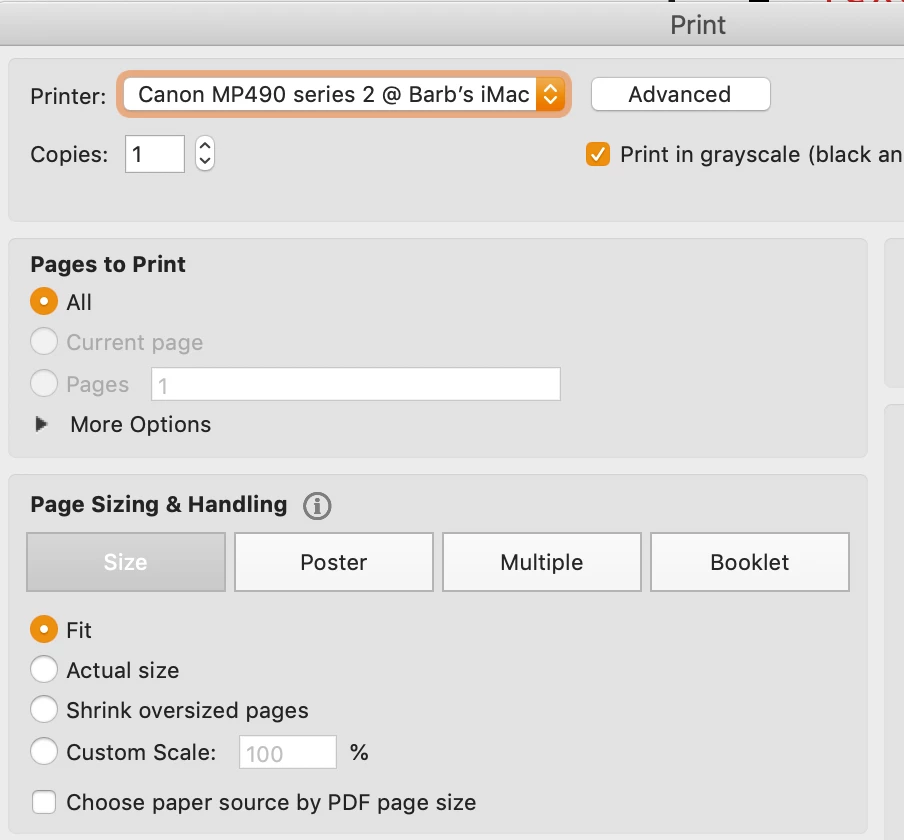

I am having a similar problem with the text in the book that I formatted (2 books actually). I used Palatino Linotype. When I create the PDF and print "actual size" it comes out fine--whether or not I use crop marks. However, the printer (whom I have used for years) prints from the PDF and the font comes out about 3 percent larger than intended. It takes up too much space on the page and looks very amateurish. I've tried every way I can think of and even tracked down the maker of the printer that they use. He helped me create a PDF that he felt they could print, but it still did not print correctly. I use FrameMaker 12. I am going insane!

    TO help diagnose your issue it would help if you describe (in detail) how you create the PDF from FM including which printer instance is used, what joboptions are used for the PDF and if the font is completely embedded in the PDF.
    If the font is coming out larger than you have from FM, it kind of sounds like you're getting a substitution at the printshop's end when they output.

    I go to "Print Book" then from printer drop down mention I select "Print
    PDF."
    In Properties, "Adobe PDF Settings" ""Default Settings" I choose "Press
    Quality" -- Fonts "Embed all Fonts." Doc size 6 x 9
    I uncheck "Rely on system fonts only . . ."
    Paper quality -- check "b/w"
    And that is about all I do. I do put crop marks in but if I save as 6 x 9
    they don't show up.

    Printing crop marks in Fm 12 was not intuitive (it is now in Fm 2019). See Adobe FrameMaker: Create a PDF with Crop Marks – Rocky Mountain Training  for details.
    Acrobat's print dialog box defaults to Fit when printing. Be sure to choose "Actual size" in Page Sizing and Handling to stop it from scaling your document when printing.
    ~Barb
    EDIT: I just reread your post and see that you know about Fit/Actual Size in Acrobat. But does your printer know about it? It sounds like the page is scaling when s/he is printing it.
