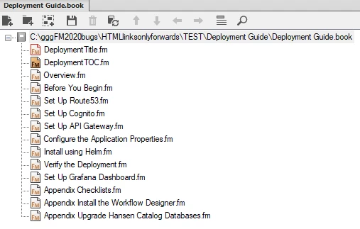

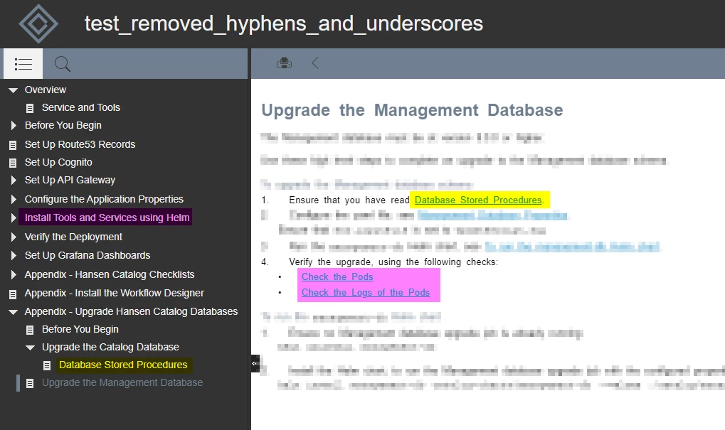

However, after spending some time with Adobe Support we have noticed something: if the target of the link is 'before' the current position but within the HTML output of an *.fm file, they work; whereas, if the target of the link is 'before' the current position and in the HTML output of a different *.fm, they do not work. I have tried to show this using yellow highlights (within an *.fm file) and pink highlights (between *.fm files).
The Database Stored Procedures page opens but the Check the Pods and Check the Logs of the Pods pages do not.

Yes, that is the same issue we are facing. If the target link is in the same *.fm file, it works. If the target link is in a different *.fm file "before" the current *.fm file, it fails. If the target link is in a different *.fm file "after" the current *.fm file, it works. Did you get any resolution to the issue?
