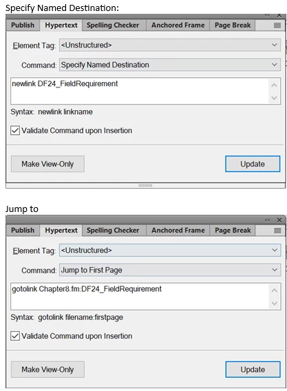

    Hi all, thanks for the responses. To confirm, the links were working in FrameMaker 2020 and stopped working in FrameMaker 2022. The hypertext markers are in a revision table and link to the changes in other files within the same book. Below are screenshots of a couple of the markers.

    Can you post the contents of one of the Hypertext markers that doesn't work in the PDF?

    May 2, 2024
    Below are a couple examples of the hypertext content.
