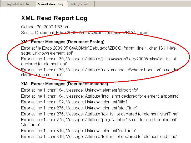

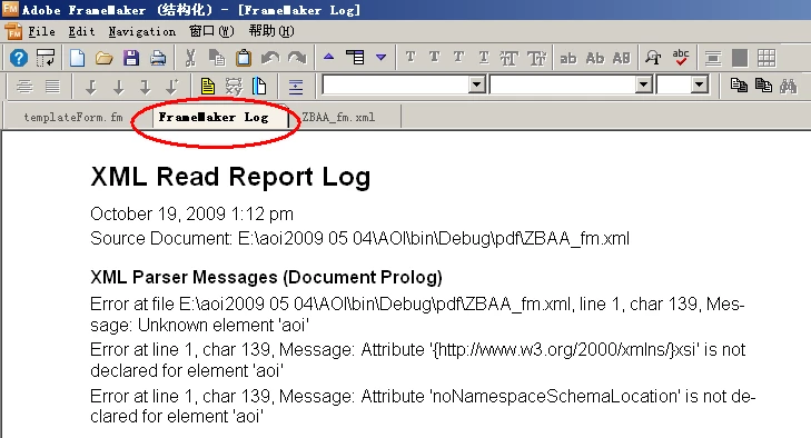

When I open my xml file in frameMaker. The file of  "FrameMaker log" always display at first. I want to control it not display at first.What can I do?

Hi Zhaopeng,
make sure the XML file is valid. If the XML parser has nothing to complain about there will be no log window.

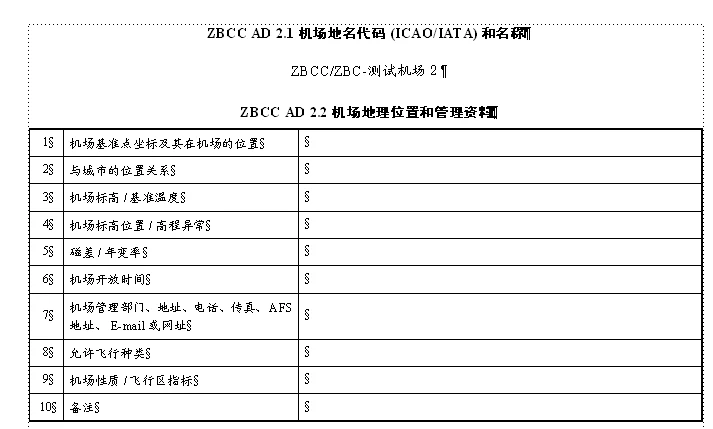

But When I test my xml in another tool. The xml file is valid. When I open the xml in structured framemaker. It will display the "FrameMaker log".But the last result (xml data+template) is correct.
According to the log file, I think  FrameMaker is not find my dtd/xsd file.But In structure application define I have already defined all nessary info.I want to know why?

Zhaopeng,
I think you are correct... FrameMaker is unable to find your schema.  You say that your structure application is set up, but something must be incorrect. Try this:
- In my experience with XML schema, I have had to define the noNamespaceSchemeLocation in my EDD for the highest-level element.
- If your XML file points to a schema location that is different than your structured application, the declaration in the XML file will take preference. It appears that the 'aoi' element does point to a schema location... make sure that the schema is actually at that location.
