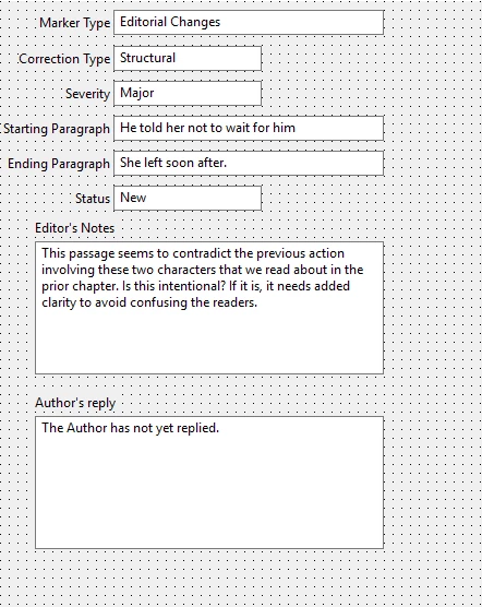

I want to create a script that
  1. Inserts a marker of a custom type called Editorial Changes. We can safely assume that this marker type (Editorial Changes) exists already.
  2. Displays an advanced marker window: Please see the mock-up window below. Studying sample scripts such as SnpCreateCheckBoxRadioButtons.jsx, I know I can create something like that window, so that's not an issue.
  3. Once the user has finished filling the fields, I want to capture the data and store it inside the marker field, say as an XML snippet.
  4. Later on, when a user selects a created marker of type "Editorial Changes," I want my script to intercept that event, grab the XML content from the marker and display my custom window with all these fields.
Does the sequence outlined through steps 1-4 doable via an ExtendScript? If you've done something like that and have a script lying around, would you mind sharing?

Note also that FrameMaker markers have an internal limit of 255 characters. I am not sure if this has changed in later versions, but you should test this before you get too far into development.

Thank you so much for your guidance, FrameExpert, especially in regards to the size of the marker. That's a great pointer. I might then create an auxiliary file to store the content in it and reload it into the window based on a marker id. To your point though, figuring it out if there is a notification for markers will be the greatest hiccup. I'll download the latest sdk. I'll report back as soon as I make some progress into this.
