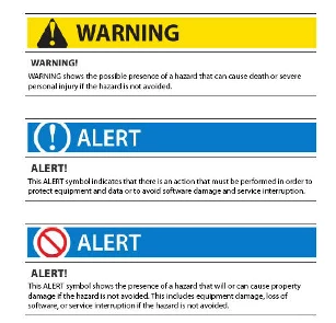

Ours look like this:
If that's close to what you want I'd be glad to share.

I am sorry, but that is not compliant to ANSI Z535 and also it lacks the freedom to add specific icons to messagepanels that are grouped into the same hazard statement (with one heading that shows the hazard level). In ANSI Z535, there are 4 very clearly defined hazard categories, although there may be a lot of specific hazards that can be grouped into these levels. The heading is described in a lot of detail and not to be messed with.
In the meantime I have decided to drop the line between the rows and I will probably use a script to make the cells in the heading into one straddled cell, so it will look perfect. Thanks for the offer.
