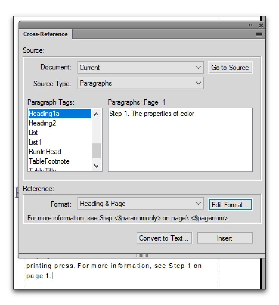

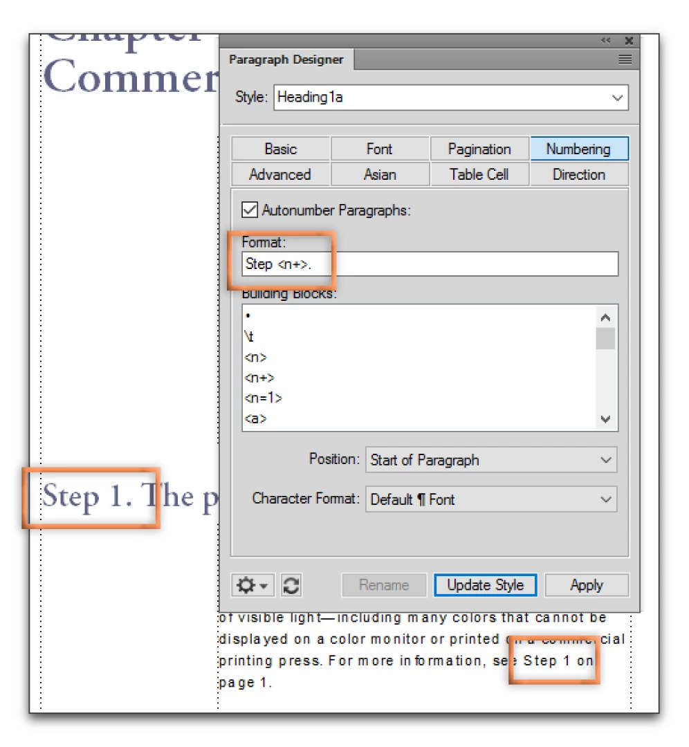

    As is mine. You can see it in the dialog box above, and in this one, below:
    In my example, the auto-numbering is set to "Step <n+>. "
    • <$paranum> will put all of it in the x-ref, including the work Step and the punctuation after the number.
    • <$paranumonly> filters out everything but the <n+>. (I added the word Step back in via the X-ref definition—scroll back up to my first post to see it.)
