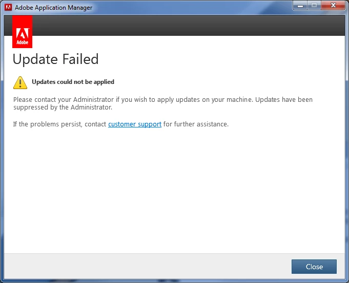

Can not update the applications that are part of the Technical Communition Suite (TCS) 4.
The updates... menu is grayed out for all applications that are part of this suit. I know that FrameMaker (FM) 11.0 has updates that should be installed. I have downloaded a patch (11_0_1) for FM and it will not install. I get this message:
I have Admin rights on the computer and have selected Run As Admin.. when I attemp to install the patch.
I have TCS 3.5 also loaded and do not have any issues with loading updates.
OS: Windows 7
Any ideas as to why I can not install updates for the applications that are part of TCS 4?

Greetings from Adobe.
Please go to C:\Program Files (x86)\Common Files\Adobe\AAMUpdaterInventory\1.0
There will be a .dat file by the  name - AdobeUpdaterAdminPrefs.dat
Capy this file and paste it on your desktop.
Open that file in Notepad from desktop.
Change the value in <Suppressed> tag to ”0”  from "1"
<Preferences>
                <Suppressed>0</Suppressed>
</Preferences>
After saving the bat file replace it back with the original file at location: C:\Program Files (x86)\Common Files\Adobe\AAMUpdaterInventory\1.0
close the window and then try to install the patch again.

Rave thanks for the suggestion but downloading and installing the updates manually give the same Update Failed message.
