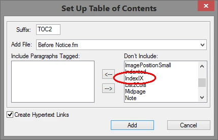

I do know how to create a standard index, how to put markers in the material, and how to use different levels of references. Usually, after I create the index, I then create the TOC. I do it in that order so that the index is listed in the TOC. But for that to happen, I need to include the paragraph tag for the word "Index," which is the title of the index chapter (along with Chap Num, Appendix, and other tags I want in the TOC). The tag for that title is "IndexIX". This works fine in several of the books I manage, but in some cases, I can't seem to keep the IndexIX tag in the list of tags to include in the TOC. At some point, that tag disappears from the list of known tags in the current book. I have no idea why that happens - I haven't removed the index from the book file, so the tag should still be there.
Here's the dialog box I'm referring to. It is posted when I select Add -> Table of Contents from the book file:
In the above example, I had already created an index, and the title (or chapter name), "Index," is tagged as "IndexIX." This tag is in the list of tags to be included in the TOC.
But in some cases - and I can't figure out why - when I create an index in a book in the exact same way that I always do it, that tag doesn't show up in the "Don't Include" list when I create the TOC.
The only workaround I've come up with is to copy a book file from another book in which the IndexIX tag is present and works correctly, delete the files in that book file, and add the files for the current book into the copied book file. The IndexIX tag is still in the list. I can then create a TOC that has the index listed. At least, this has worked in the past. I haven't needed to do this for a few years, but I am now creating a new book that needs an index, and this time, even my workaround doesn't work. Anyway, there ought to be a more straightforward way of getting the index listed in the table of contents.

re: ... can't seem to keep the IndexIX tag in the list of tags to include in the TOC.
You might try instead making the first paragraph of the Index a normal Heading1 (or whatever you use for chapter heads). Then the Index title gets picked up for TOC just like any chapter title. You hand type "Index" into the IX file after it's generated for the first time.
FM does not over-write that on regeneration of the IX (same is true for TOC). I haven't extensively tested it, but I suspect FM doesn't over-write any non generated text that appears before the first line of generated text in any generated file.
Conversely, however, you don't want the "Contents" heading to be picked up in TOC, so make it some Heading variant that is ignored, like Heading1.ign
