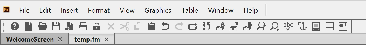

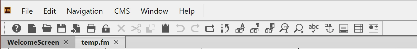

Check the menus in that file, Kevin.
An unlocked file:
Vs a locked file:
Click the padlock icon on the toolbar to toggle between view-only (locked) and editable (unlocked).
