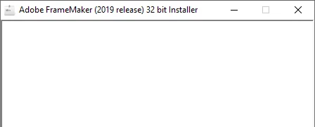

I downloaded the Zip file for Update 5 of FrameMaker 2019 (32-bit), but when I launch the .exe file, a completely empty dialog box titled Adobe FrameMaker (2019 release) 32 bit Installer opens.
I have no clue how to resolve this .. I have admin rights on my computer.
Does anyone have any ideas?  The updater task is running in Windows, and it's not "Not responding" (screenshots attached) Thanks!

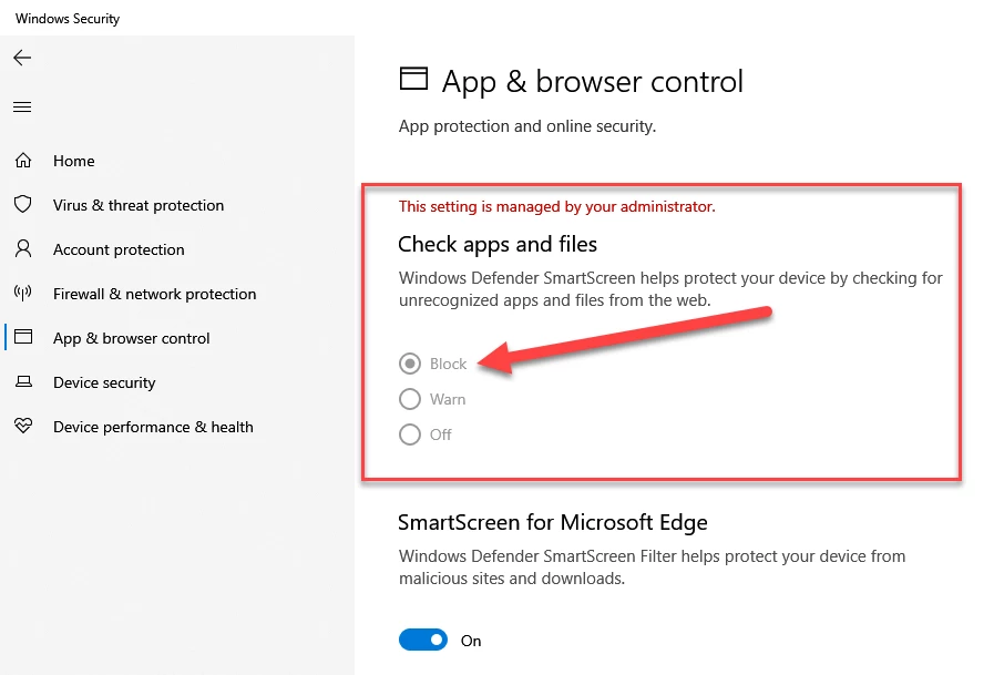

After a super long call with support, this is finally solved.
In my case, the issue was that Windows Defender SmartScreen was blocking unrecognized apps (see screenshot below). The Set-up.exe file does not seem to have a recognized publisher.
When our IT director pushed an updated policy to set that to "Warn" (instead of "Block"), I was able to install the update.

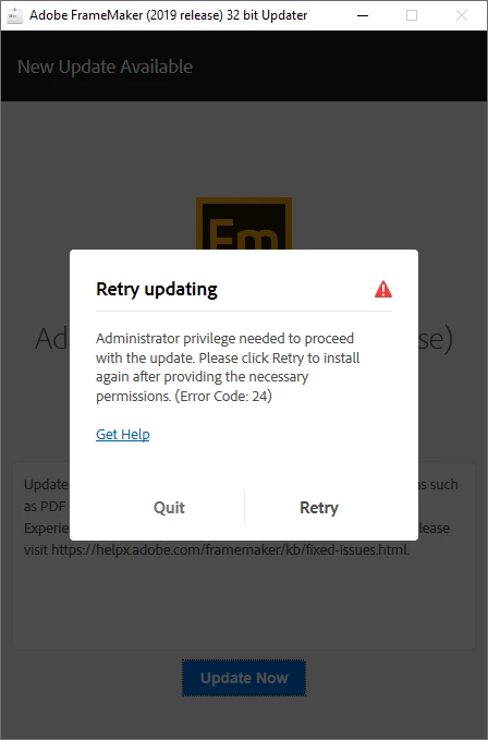

The set-up.exe (yes, not setup.exe) is installed as "blocked" so I couldn't run it, even as administrator. I have administrator rights on my machine, and I also have a local admin login. After going through all the settings with our IT director, the result should be that I can run the update, but I still can't. I am going into the office tomorrow and will try to run the file as local administrator (Adobe insisted I do this although we don't think that's going to make a lick of difference, but we'll try). I will post an update here when I have it.
FYI - the article they pointed me to is: https://helpx.adobe.com/in/tech-comm-suite/kb/blank-screen-install-robohelp-framemaker-2019.html
I followed the steps there with no luck. I did get further along in the install - but then it still fails with this message:

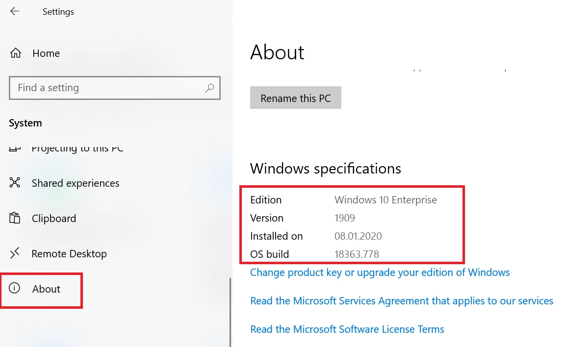

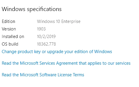

Apr 21, 2020 9:34 AM UTC
Hi Anette,
can you please let us know which exact version of Windows do you have?
You can find this in Windows Settings > System > About:
Also, please check, if you have Internet Explorer 11 installed, which is a system requirement.
Also, the screenshot of the Welcome Screen looks like your firewall is blocking something.
Kind regards,
Stefan
Apr 21, 2020 5:16 PM UTC
Windows version below. I also have IE 11 (11.778.18362.0; update 11.0.185

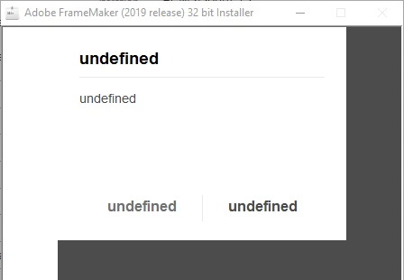

I decided to try to download FM 2019 again and then re-install - but it turns out I can't even uninstall the current version (even as administrator on my machine). As soon as I try to uninstall, I get the same Adobe FrameMaker Installer dialog box that is completely blank until I click the X, at which point I get the "Undefined" areas.

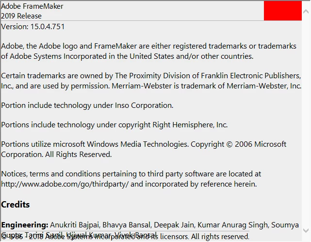

This is what my "About FM" dialog box looks like:

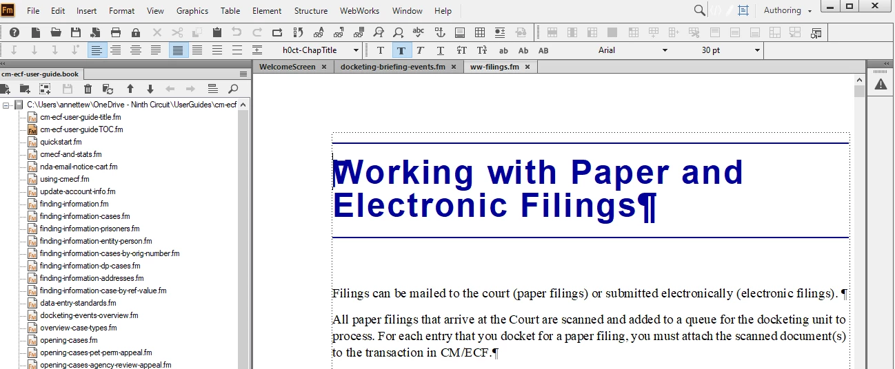

One thing I noticed - when I click the X to dismiss the dialog box, I get "buttons" that are "hot" but undefined and they don't seem to do anything at all.

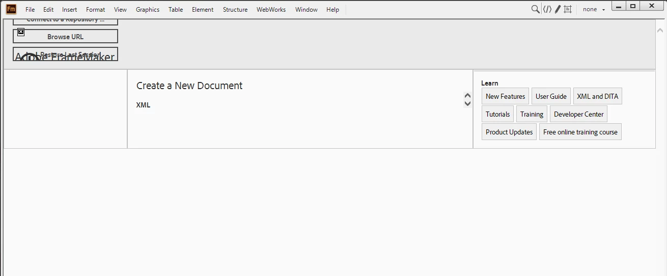

When I launch Frame, the Welcome screen it looks very strange (this started happening with last update) - but everything  works fine once I open a file. I've attached more screenshots.

I tried that first and got the exact same empty dialog box. Sorry, I should have mentioned that.
