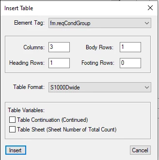

I want to make some small changes in S1000D tables (for instance Require Condition in the procedural module) in Adobe Frame Maker 2019, S1000D. I changed ".edd", ".tpl", ".rwr".  But when I want to save a procedural module, I got various errors. I want to know which files do the validation when saving any data module?
As a simple action, I tried to change the size of the column of the "fm.reqCondGroup" table in .rwr. file but I couldn't see the changes' effect. Do I miss anything here?

 What is strange for me is that in FM when you want to create a "fm.reqCondGroup" the default value of columns is 3, however it is defined as "1" in .rwr file. So, I thought maybe another file is responsible for the validation.

ReadWrite Rules for tables
This certainly looks odd, but there is some sense to it!
  • The fm property columns value is "1"; line is telling the XML handler that this table must only have one column in this instance.
  • The fm property table format value is "S1000Dwide"; line is then telling the formatting engine to apply a specific table format.
The number of columns in the table takes priority over other properties that are defined in a table format. The reason for having three columns as the default for the S1000Dwide format is to make normal editing easier for the author. In this case we use this format because it does not have a left indent. You can change the default in the main structured templates and these will be used the next time you open an XML data module.

   Read/write rules modify FrameMaker's default correspondence between its own representation of elements and XML attributes and that of XML. FrameMaker uses these rules whenever you read (open or import) XML or when you write (or export) XML. In your example, you have three rules of the form:
      fm property x value is "y";
Such rules pertain to an element used for a FrameMaker formatting object other than a paragraph or text range within a paragraph. Examples include tables, graphics, and cross-references. Each such element has a fixed list of properties and read/write rules may map them to an XML attribute or assigned fixed values. "Value is" does the latter and tells FrameMaker to use the specified value when reading XML and not to represent the property's value when writing XML. Read/write rules are not used when you are editing FrameMaker documents.
   Thus, your rule
       fm property column widths value is "170mm";
tells FrameMaker how wide to make columns in tables it reads from XML. It does not affect tables you create when you are editing in FrameMaker. To specify the default column width in FrameMaker do the following:
1. Open your template.
2. Use Table > Insert Table to create a new table. Specify that the new table should use the format you want to change and the number of columns you will typically use for that type of table.
3. Click in a column you want to resize (or select an entire row if you want all columns to be the same size).
4. Use Table > Resize Columns to set the column width.
5. Use Table > Format > Table Designer to open the table designer.
6. Click Update Style.
7. Delete the table from the document.
8. Save the template.
