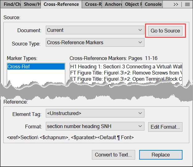

    Are you talking about a cross-reference link?
    If so, there are a couple things you can do. There's a Cross-References pod (View -> Panels -> Cross References) that gives you a listing of all cross-references in a document or all open files or, if you choose a book file, all the cross references in the book.
    It gives you the information inserted into text, where the cross-reference is inserted, and what it refers to.
    Or you can keep the Cross-Reference window open and after you get to a reference, you can click (BUT NOT CTRL+ALT+CLICK) on it you can then click on Go to Source, which is next to the field identifying the document name and it will take you there.
    Either way should give you the information you need. The Cross References pod (1st image) will also show a little red X to the left of the cross-reference text if the link is bad.

    Click the Filter icon and select the name of the book file.
    ETA: The Go To Source option will take you to the place being referenced, but you have to select the cross-reference for it to work. And to get back where you started from, use the CTRL+ALT+click on the cross-reference.
    The first option does NOT take you to anywhere in the book. It's just a list of the links.
