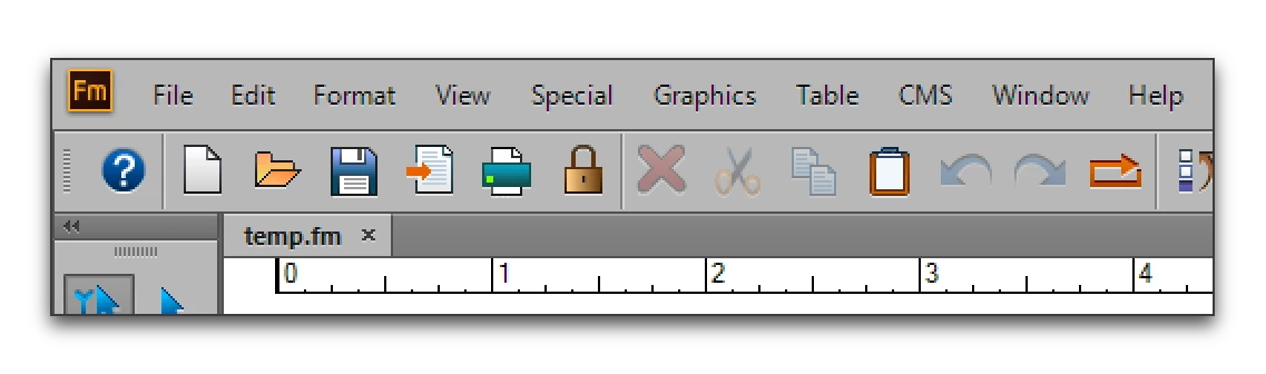

    That said, here's the trick on figuring out if the document (or book is locked)—watch the menus, and the the subtle change of the golden lock icon in the toolbar.

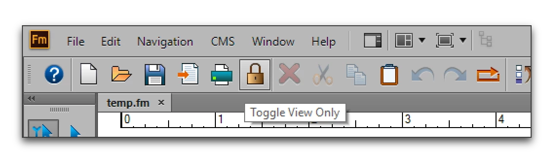

    Unlocked document:
    Locked document (shorter menus and displays the navigation menu):

    Barb, the only thing is that you have to be IN the document to get that change in the menu, it doesn't show it if you step through the list of book files. Nor does the Hypertext status change when you step through. So you need to OPEN each file. No one would normally think of having to do that. The lock symbol by itself does not give a status either way, only the one Toggle View Only tooltip.
