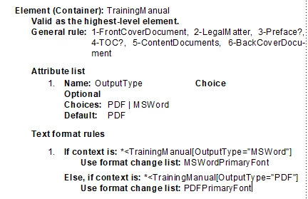

I have the following Element set up in my EDD:

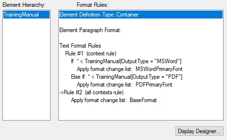

When I use the TrainingManual Element, no matter which Attribute option I select, the Context Rule is ignored:
I've used similar Attributes on other Elements without any problems. I'm at a loss as to what I'm missing and why it's not working.
    Lynne A. PriceCorrect answer
    Mar 14, 2022 2:05 AM UTC
    Quintin,
       Two possibilities occur to me:
    1) If the TrainingManual element is in the book, changing the attribute will not affect formatting within book components, until you update the book. (This design allows one file to be used as a component in different books. For example, you may have one book with OutputType set to MSWord and another with OutputType set to PDF. You can update either book to set the formattig in all its book components accordingly.)
    2)  Rule 2 might overwrite formatting made in rule 1.
    --Lynne

       Your original context specification was:
           * < TrainingManual[OutputType = "MSWord"]
    Since you used this context specification in a format rule for the TrainingManual element, you were testing for a TrainingManual that occurred within another TrainingManual where the outer TrainingManual had set the OutputType to MSWord.
       If TrainingManual elements do not nest, a rule with this context specification will never fire. To test an attribute value of the element being formatted, just use an attribute test. The entire context specification would be:
         [OutputType = "MSWord"].
      By the way, you could use the original context specification to format any subelement of a Training Manual with the specified attribute.
         --Lynne

    Mar 11, 2022 2:44 AM UTC
    Turns out I had to remove the *<TrainingManual from the Rule. However, I now find that the Context Rule is re-evaluated when I change the Attribute to another selection.
