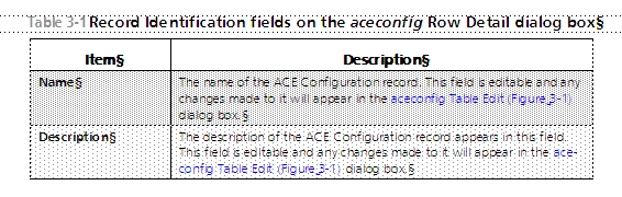

I'm in the process of converting unstructed FM8 docs to structured docs using FM10 and DITA structure. Right now I'm trying to build a conversion table to structure the docs, but I'm having a lot of trouble with the tables. The main problem seems to be with the tgroup element since I can't figure out how to get the thead and tbody to wrap in the tgroup element.
Here is an example of one of the tables I'm trying to structure:

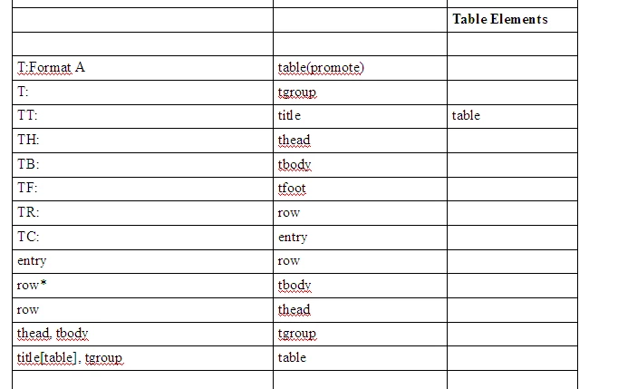

This is the Table section of the conversion table I've had the most success with:

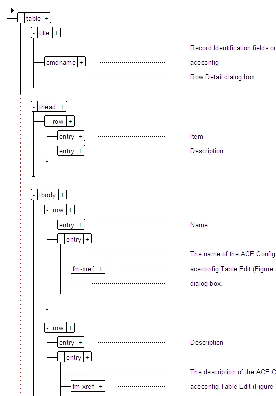

And this is the result:
As you can see, the thead and tbody elements are not wrapped in tgroup and the structure is invalid. I've been playing around with the conversion table for several days now and can't seem to figure out how to fix this. If anyone has any suggestions, they would be greatly appreciated!

5) Your conversion table had one row with T: in column 1 and another with T:Format A in column 1; one mapped to table and the other to tgroup. The row with T:Format A would apply to all tables with the specified format, the other row would apply to all tables with other formats. These conversion table rows do not define a relationship between table and tgroup. Map T: to table if you want the model in 4b) above and to tgroup if you want the model in 4a). In the latter case, use an additional row with:
title?, tgroup
in column 1 and  table in column 2.
