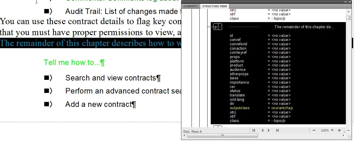

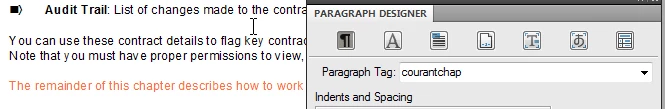

Another question on the context rule. How does order matter? It seems that no matter the order I use, I cannot get the EDD to apply my actual body style to my paragraphs. It always uses a different style or no style at all
So even this
If context is: [outputclass !=”courantchap”]
Use paragraph format: courantchap
Leaves me with no formatting (never mind when I add the Else If statememts). When I check the attributes under this paragraph in the structured doc, the outputclass is applied.
Can you see my screen shots and let me know what you think is wrong?
This is the unstructured view of the paragraph formatting (color is denoting conditional text)
This is the unstructured view. See how the paragraph formatting is not applied, even though the outputclass attribute is applied

I'd imagine that your EDD edits aren't getting applied, but it's hard to say. There are many steps in this process and any one of them can cause things to not work. I'd suggest that you separate the conversion and formatting as two completely separate worlds. First do the conversion ..
  • Apply conversion table to unstructured file(s) to generate structured files
  • If successful, import the template and EDD (two separate steps, just use the default apps, don't bother with formatting or customization here)
  • Validate and clean up the structured files
  • When completely valid (using Element > Validate), export to XML
Then, open your XML files in FM and see that all's well. Now you can start thinking about customization. DITA is DITA, there is no formatting in the XML so it doesn't matter until you want it to matter. Yes, your conversion table may have preserved "styling" through @outputclass attributes, but that is only applied when the EDD is set up to apply it. Until that time, it's just an attribute on an element.
Now clone the default apps and create you own custom app. It's always best to clone and create your own app, and preserve the default apps in their original state. You need to have something to use when (and you will) break the apps. Once you have a custom app, you can test that on your XML files. The hardest thing about the DITA 1.2 apps in FM is that it's difficult to know which EDDs import into which templates, and making sure you have the right conditional settings and making sure you update the EDD insets in the right order.
You can short-cut things a bit during development by importing the modified EDD (after resolving all insets) directly into your open XML file. This can let you make edits in the EDD and import to immediately see the result. Once it's working, you can then import the EDD into the template so it works properly.
