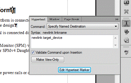

I would like to create in Frame a destination that appears in the pdf as a destination, I would think this would work:
but in the pdf file, it doesn't appear, is there another way? Are my settings correct?

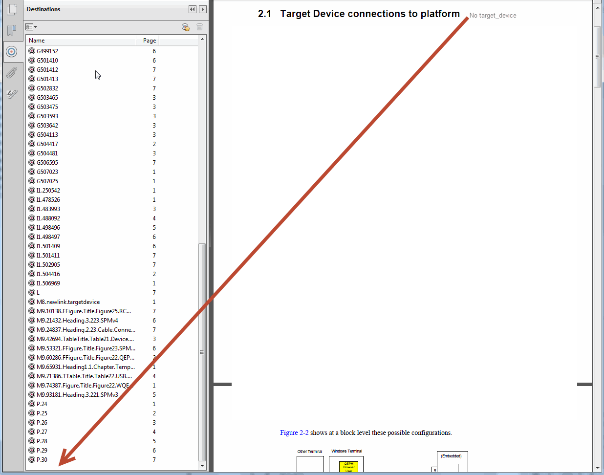

FM adds a prefix to the named destination in order to make the destinations absolutely unique. Depending upon whether the file is part of a book or a single file, the exact string will vary.  For a standalone file, it will be "M8.newlink.<your newlink text, e.g. target_device>" or if it's part of a book, "M1.8.newlink.target_device> where th digit after the "M" refers to the files position in the book.
You either have to add the prefix to the PDF links that you manually want to create in other applications that target the PDF you're creating or use Shlomo Perets' TimeSavers (see: FrameMaker-to-Acrobat TimeSavers ) to have the prefix stripped.

Thank you, we're almost there, the only difference seems to be that underscores are ignored, so "newlink target_device" comes over in the pdf as M8.newlink.targetdevice, which I can live with.
Besides Timesavers, there is also the EverClear product, but this will do for now

Yes, all newlink punctuation marks (_, / . $ etc.) are discarded when translated to PDF.
