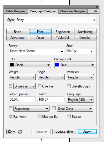

I want to create a paragraph tag with a colored background. Black background  - white text.
There is a font option allowing me to set a colored  background, and I can set a stroke above and below the text. But it seems I cannot totally avoid having a single, thin white line below the text.
Working in FM 2019. Is it really not possible to have colored background and extend the background color above and below the text?

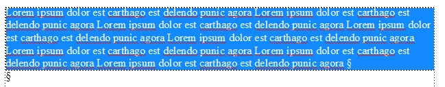

Yes, you can put a background color for the font, but that is limited to the characters. It's not really a background for the entire paragraph. It won't look like a box, in other words, it'll look like this at 100% zoom [which makes those white lines between each line of text disappear (and holy cow, what happened to the resolution?)]:
If that's what you want, then try setting the line spacing to just a bit less than your font size. My font was set to 14 for the example; when I made the Line Spacing 12 pt, the gap between lines disappeared no matter what the zoom. It makes the text tight, though.
ETA: This is an example of a single-cell table formatted as I suggested above:

We can add a background colour to the paragraph, like the blue colour which is chosen here. It seems that the background colour is tied to the line height of the font in use. Ideally I would like to be able to stretch the background colour up and down.
I just wish it would be possible to have the Line above/Line below go all the way up to the fonts baseline, but I cannot make that work without leaving a thin  blank line.
The workaround with the table cell is ingenous though!

Frame doesn't have the ability to put background shading on a paragraph.
The usual workaround is to put the paragraph into a single-cell table with no borders and set the fill.
If you put your anchor into its own paragraph, define the paragraph tag with Space Below equal to the -font size (for example, -12pt), and define Space Above for the Table the same way (-12pt).
