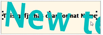

  1. Source TextLine selected, then script applied:
    Resultant 'clone' is an object TextLine, indicated in the status line as  O: fh2-fig-heading2*
    but using colour ddd-3 (used in table heading cells etc.)
    Selected as text it has no style, but size is 128 pt (as used by a specific ¶ format) and font family which can be from fh2-fig-heading2 but also from the specific ¶ format
  2. Now I select the cloned text (the green one) as text and apply the character format fh2-fig-heading2.
  3. Now i delete the clone TextLIne (the red one), select the source TextLine again and run the script:
    Resultant 'clone' text is an object TextLine as before indicated in status line and text has character format (obviously from the manual action before deletion).

Remember that Doc objects have their own text properties. Try this code, then create a new text line and see what it looks like:
#target framemaker
var doc = app.ActiveDoc;
doc.FontSize = 65536 * 18; // 18 points
doc.Color = doc.GetNamedColor ("Red");
This may solve the mystery for you. -Rick

During shaving this morning it came to my mind that a TextLine is a double faced object: part of its properties are that of the TextLine object, part are that of the 'mother'-object document (the text itself).
oTextLine.StyleTag is not a character format, but a style defined with the Object Designer. And this sort of style can only contain Alignment (AsIs, Left, Right, Center) and Direction (AsIs, Inherit, LTR, RTL).
Since eventually I want to create textlines using various character formats (e.g. 17.5×10-3) - bold for the full text, superscript for part of it - that obviously must be done with text ranges.
