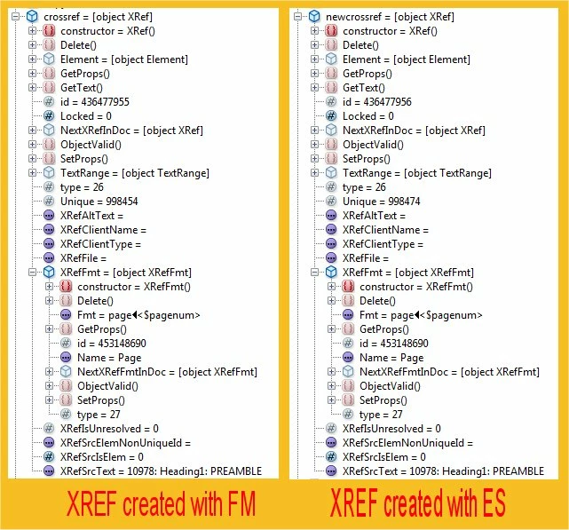

I have been trying to create the XREF following your suggestions:
  1. First I created a XREF using the FM procedure. Then I created a code to get the info from Data Browser in the ESTK.
  2. Then I created a XREF using my own code: FM recognizes the XREF (as you can see on the right image) but I cannot get any cross-ref on the content.

Your code does work, but you forgot to update the cross-references in your document. To do this in the code, add the following line to the end of the XRef insertion code snippet:
doc.UpdateXRef ( doc, newcrossref );
