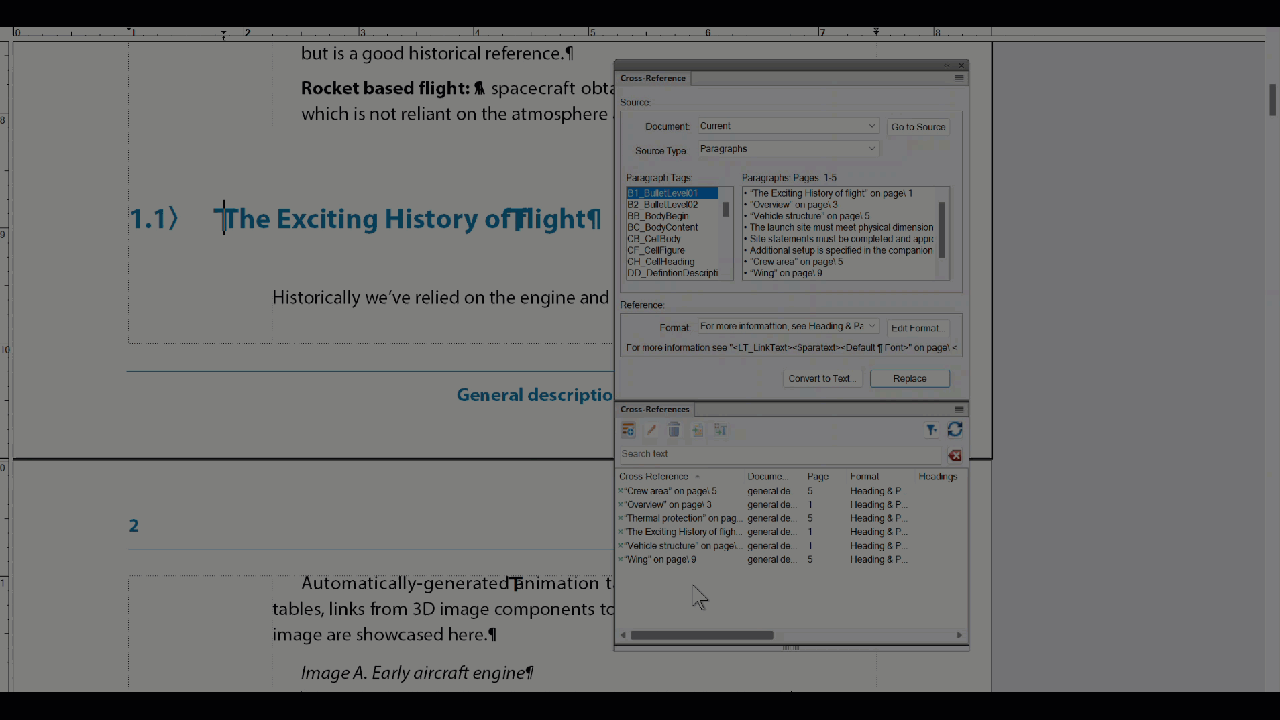

    In this clip, I break the x-ref and when I go to fix it, Fm changes from Source Type: Paragraph to Cross-reference Markers. I then have to choose Paragraphs, and then dig through the Tags list to find the paragraph style again before I can locate the text.
    In a situation where I'm working on a document with lists of  x-refs instead of a mini-TOC, the extra clicks are painful. I truly believe Fm didn't used to switch types.

    It works that way in my copy of FM12 too Barb - it seems to start with the default set to Paragraphs, but if I'm editing xrefs, it flips to Cross-Reference Markers - I guess the idea was to be helpful? It would be grand if there was a maker.ini setting to set the default preference, but I've never heard of one.

    It's early here in Colorado.  I'll come back with a screen shot it a little bit, but it seems to me it's when I'm editing paragraph x-refs. Fm changes it to markers and I have to change it back and then find the paragraph style.
    I can tell you it's definitely a pain point but I've been sighing and plowing through and never got around to reporting it. It's been an issue for the past few years, so at least 2020 and 2022. Likely also 2019.
