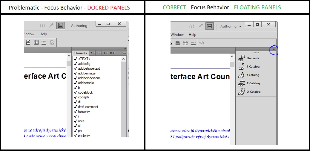

Please try if this workaround works for you:
  1. Bring the Panel in use in "Floating Mode"
  2. To make it in a floating mode: Click on the 2-small-arrows towards the top-right of a panel and make it in a bubble shape. (refer graphic)
  3. Click on the bubble to open the panel
  4. Click on the desired selection
  5. Correct Selection should now be made
March 22, 2016
