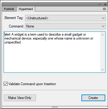

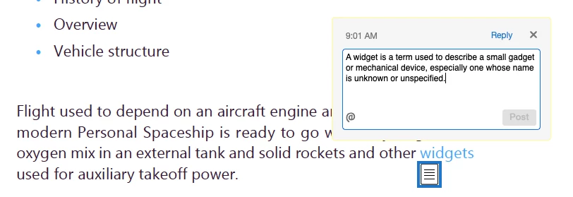

Along with Shlomo's plugin, you can use an Alert hypertext marker to display a pop-up note in PDF, as shown below, but the note icon often shows in a conspicuous location, meaning you may want to reposition and resave the PDF after publishing.
Here's the marker used to produce the PDF shown at the bottom of this post
Here's the PDF output (I repositioned the text of the alert for clarity. One thing to note: I tried using the alerttitle hypertext command, which adds a label to the text box, but it wasn't working as anticipated.
