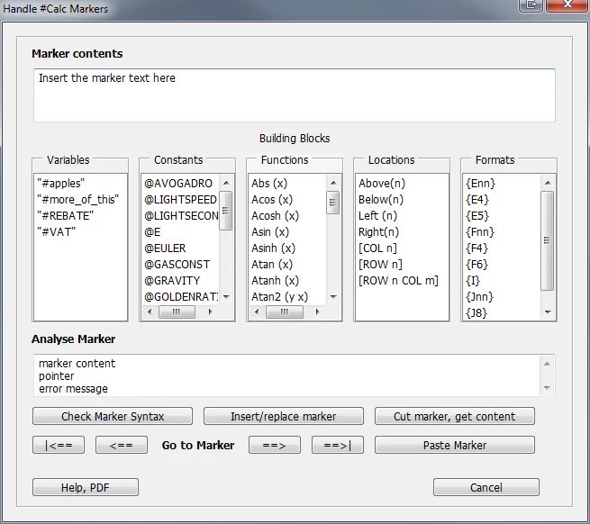

I have a rather complicated dialogue and want to use the step-by-step walk-through to check variables etc.
As soon as I press a button in the dialogue the related code in the callback routine is run - no chance for step-by-step operation:

To illustrate: this is the dialgue
and this is the callback routine for the button ==> (next)

April 18, 2016
Although knowing the $.bp (true); statement I did not realise that ESTK does not get control...
win.p0.g3.btnNext.onClick = function () {
      $.bp (true);
      goCurrentMarker= GetMarker (oDoc, sMarkerName, "next", goCurrentMarker) ;
      win.p0.sMarkerContent.text ="";
      gsMarkerText = goCurrentMarker.MarkerText;
      win.p0.sMarkerContent.textselection = gsMarkerText;
I thought that the script is run in the environment of ESTK (even with #target framemaker) while debugging.
But this is not true.
  • Hence after inserting the $.bp (true); statement
  • I must save the script,
  • Run it (F5)
  • The dialog appears and i click on the button
  • In ESTK the line with the breakpoint is highlighted
  • And I can step further
I did not get this awareness from the JavaScript Tools Guide (which IMHO should be titles ExtendScript ...) but from experiments. The ralationship between the target enginge (framemaker) and ESTK is still a mystery for me. The wording "target engine" does not appear in the JS Tools Guide! It is called JavaScript engine.
