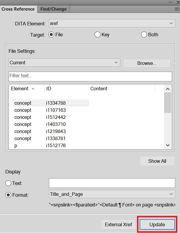

Does anybody know how to update cross-references with ExtendScript
Does anybody know how to update ?

Thanks, but it didn't help me. Maybe, I will need to go through each cross reference and update individually as I do it manually ?

I'm able to update manually. But it doesn't work with the script.
var doc = app.ActiveDoc;
doc .UpdateXRefs(Constants.FF_XRUI_INTERNAL);
