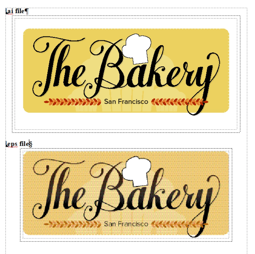

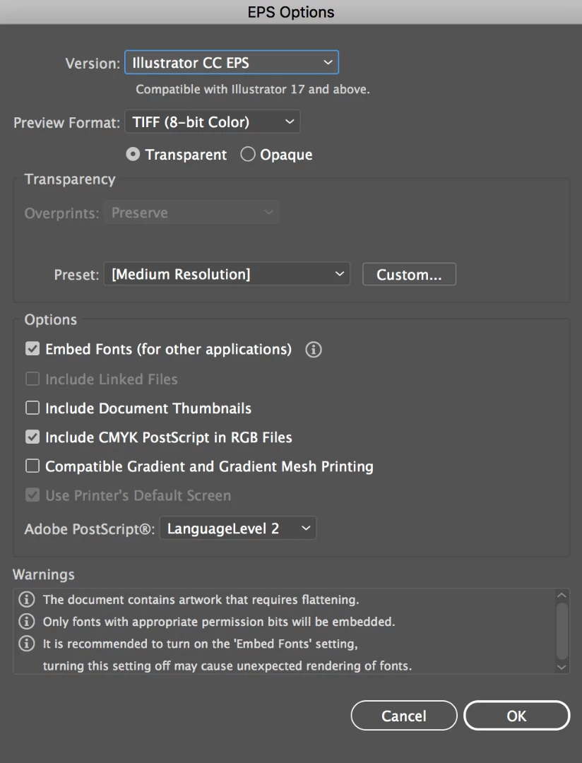

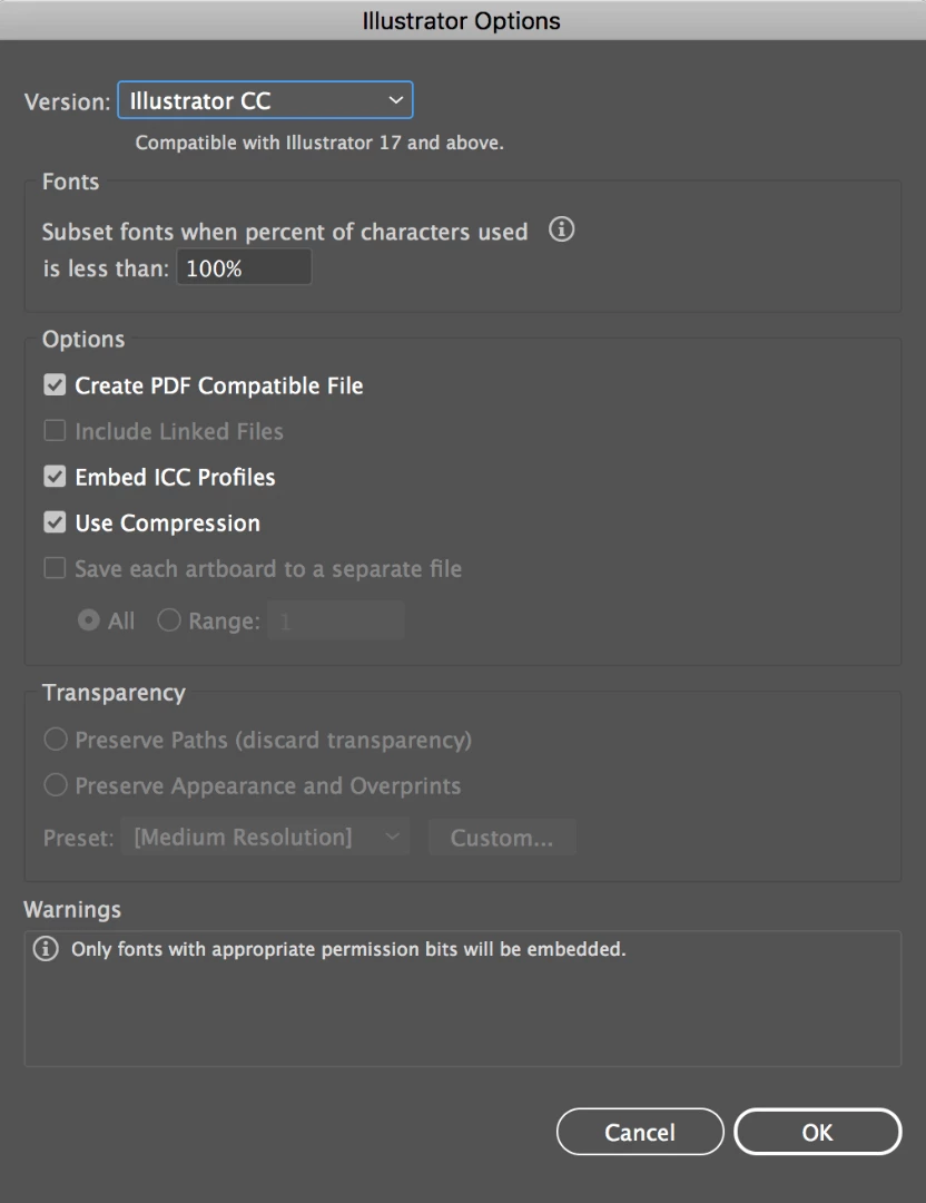

    I'm not seeing this issue. Below are two files from Illustrator 2017 (v 22.01), the first saved as Adobe Illustrator (ai), the second as Illustrator EPS (eps) with these options. Are your files saved as an older version? A different preview format or no preview format? Do you see anything different in the export options dialog boxes?
    The previews look different from each other in Fm but they output the same to a PDF. Imported via File > Import > File into FrameMaker 2017 (14.0.2.425):

    I tried matching your settings above, and there is no change. (The only change was in the Save As EPS... Include Document Thumbnails setting - mine was turned on.)

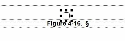

    Here we go. I'm inserting a graphic. I get a tiny (highlighted) box with handles that I have to drag out to the approximate correct size of the graphic (font here is Arial 10 Bold for size comparison):

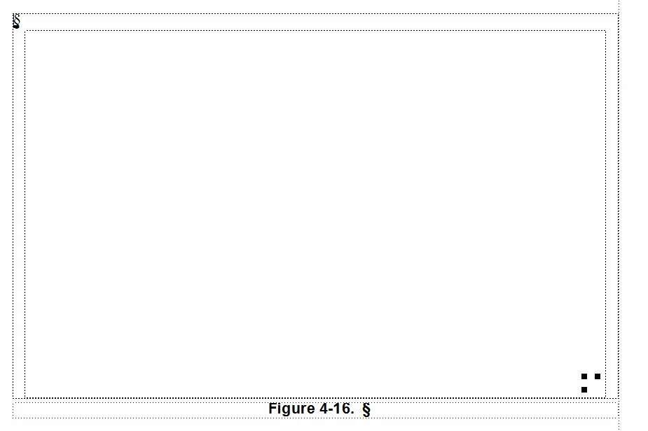

    Now, step two - I've dragged the box to the approximate finished size of the graphic, and clicked on the interior of the frame, then  dragged through the periphery of the bounding frame to find the actual location of the graphic:

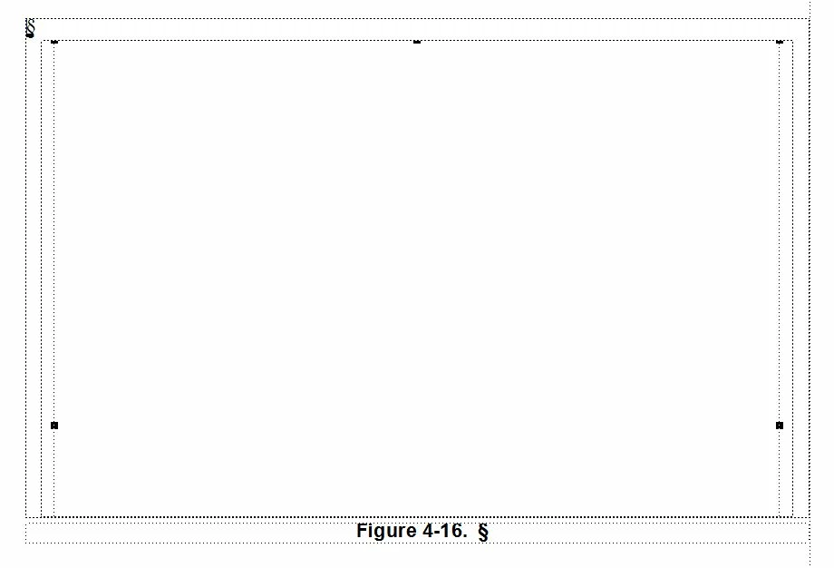

    Yes, that's it, hiding down in the right corner. Notice that it's not a thumbnail, but an empty box. But at least I have grabbed it. Now I go to the Object Properties and choose an arbitrary size (say 70%) and apply it. I then click on the buttons to set it against the top of the frame and to center it. This is what we get next:
    Yeah, it's too big, but I'll fix that once I can see it; it may be a matter of tuning the graphic in Illustrator; but I need to see it in place, first.
    Notice that the graphic 'kind of' appears to be inserted, but no thumbnail is visible. (Oh, and printing the page gives me a blank frame; so the graphic isn't really inserted.) From here, I double-click on the graphic, which will then eventually open in Illustrator. I then make a tiny change - enough to cause Illustrator to think the file is changed. I then SAVE from Illustrator. As soon as the Save completes, I then go back to FM and click once on the graphic. This will cause it to be both imported and displayed, and from there I can tune the layout. Once it's in, it's in for good. No problems afterward.
