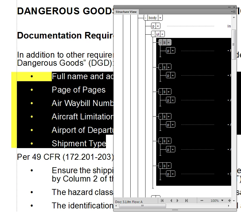

First, here is a picture to illustrate what I am trying to do:
Given an ElementRange, I am trying to find the upper and lower boundaries of that range, as in the FP_LocY values (show visually in yellow). The upper value is easy, because I can get the top element in the ElementRange. But I am not sure the best approach for getting the lower value. Any help will be appreciated. Thanks.

frameexpert
Aug 25, 2016 12:46 PM UTC
Here is some back story on what I am trying to do. I need to draw pseudo change bars in the margin next to elements with a particular attribute, or alternatively, next to an element selection. So I need to find the "top" and "bottom" elements in the range. Then I calculate their LocY values so I can determine the height of the change bars. In experimenting, I have found some strange issues when a single element with children is selected. In this case, the most accurate results come when I use the first child and the last element in the selection to get my values. Thus, in the screenshot, if it was the entire ul element that was selected, I would want the first li and the very last p in the branch to get the correct values. So I have come up with this somewhat convoluted code, which seems to satisfy any combination of element ranges. Of course, I still have to deal with selections that cross text columns or pages, but that is the next task to tackle.

4everJang
Aug 25, 2016 12:30 PM UTC
Hi Rick,
If you look at the structured document with element boundaries switched on, you will see that the textrange of the last <li> does include all of the child elements inside that <li>. This means that the text location of the end boundary of that <li> is in the same paragraph object as that of the last <p> (or anything else) inside that <li>.
There is no need to make things more complicated than they already are. Unless there is something else you are trying to do here.
Ciao
Jang
4everJang
Aug 23, 2016 8:42 PM UTC
Hi Rick,
If I understand correctly, you are looking for physical (i.e. screen) locations rather than logical or stuctural locations.
Use the TextRange of the last element in your range to find the last paragraph in that last element. Then select the next paragraph in the same flow and you have the lower LocY boundary of your selection. Of course that next paragraph might be on a new page.
