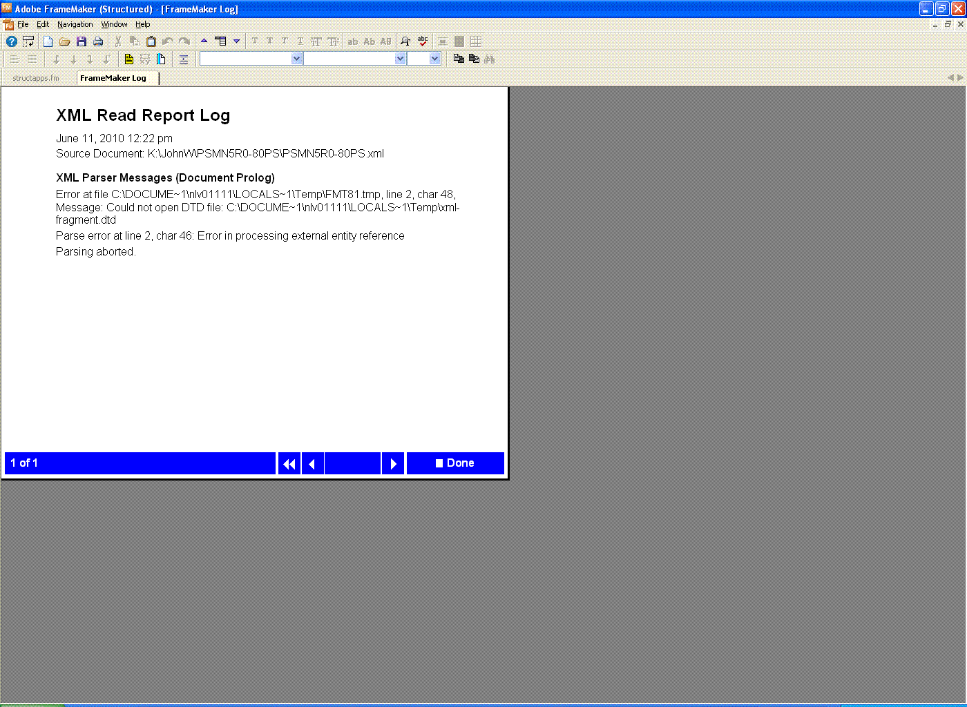

Here's the screenshot of my structured app in FM8:
Here's the XML Read Report Log:
Rgds,
John
John,
I see you have the Read/Write rules search path specified (which seems to be of no use because you specified a full path for the R/W document).
Now add the Entities search path specifying the folder of the DTD. Then FrameMaker should be able to find it.
I usually specify the DTD with a full path as well, having the path in a variable, so editing it is easy.
- Michael

Yes, the XSL snippet I included is taken from the XSL that is used during preprocessing upon opening the XML.
I tried what you suggested, but get an error.
I guess this is because the processed XML is stored in a temp directory, so the dtd is not available in that location
John

OK John, with XSL preprocessing an intermediate XML file is created in your TEMP folder. FrameMaker opens the XML from this location and therefore most relative paths to DTDs will fail.
The resolution I use is to add a simple local reference to the XML resulting from the XSL preprocessing using the instruction
This DTD must be valid for the XML after the XSL preprocessing, of course. Also make sure there is no older version of your DTD in the %TEMP% folder, because if FrameMaker finds something at the original location it will not go and look in the search paths.
