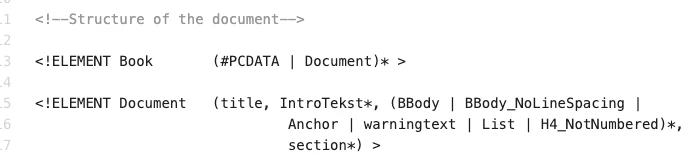

Errors in dtd element names
Sometimes when we open an XML-file from a book it will not open but generate a lot of errors. I found out that this was caused by the dtd. Some of the element names starting with an upper case are changed to lower case without any reason. For instance "Title" is changed to "title". We did not change the edd or the dtd! If we try to save the edd as a dtd (with the proper names such as "Title"), in the dtd the element name is changed to "title". To make it more strange, this happened only a few times the last couple of years. But is is realy annoying and costs us a lot of time.

    I just created a simple EDD that defined two-elements: BrandNew and Title. With no application, I created both an XML and SGML DTD. Both DTDs used the same case as the EDD.
    When I encounter the kind of problem you describe, I simplify as much as possible. A simplified application does not need to support all the elements and attributes in the actual application. It doesn't have to work. You have already determined the problem is in the generated DTD. Two areas you can simplify are your XML application and the EDD. What happens if you generate a DTD from a two-element EDD such as the odne I described above? Try one element that appears in the real DTD with the desired case and one in which the case is changed. If you find the problem occurs in the simple test case, check your r/w rules. If you remove the r/w rules from your test application, does the problem still occur? If not restore the r/w rules but remove successive rules from the file to see if there's one that causes the problem.

    arnor33453439
    May 25, 2022 12:26 PM UTC
    Dear Lynne, thanks for your reply. The problem indeed seems to be caused by the read write rules. I tested it with a simple EDD, with the read write rules disabled it works fine. I have modified the read write rules, everything seems to be working fine now. However, it remains strange that only one of our many projects goes wrong. I can't figure out why. The other projects use the same read write rules....
    May 25, 2022 7:58 PM UTC
    Arnor,
       What change did you make to the r/w rules that fixed the problem in the troublesome project?
       To pursue this problem, I would look at details such as:
    1. What version of FM are you using?
    2. Do you get the incorrect result with the original rules if you reboot (better yet, restart) your computer before generating the DTDs?
    3. Do you process all projects on the same machine? Same application definitions (probably structapps.fm)?
    4. Do you change maker.ini for the different projects?
    5. Is there any possibility that there is an inadvertent difference in the rules used by the different projects? What happens if you copy the failing rules to a project that doesn't show the problem.
    6. Does the order of element definitions in the EDD or rules in the rules file make a difference?
    I would probably start with the working and failing EDDs and make numerous successive changes to the EDDs and rules until I got the same result for both. Hopefully, that will reveal the significant difference. I'd start by deleting rules and element definitions that are not relevant to the problem. The goal would be to reveal the significant difference, not to create a working environment.
    Good luck,
       --Lynne

    May 24, 2022 9:50 AM UTC
    Below I've posted two screendumps of the dtd and the edd. Look at the mentioned "title" element.
