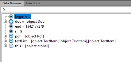

In the data browser box in ExtendScript, it shows this when it hangs up:
i = 9. Is that what you mean?
No, the variable num.
Your getFigOrTable function only returns num if the regular expression matches. Otherwise, it returns undefined, which is why num.index is failing. You need some kind of test for num after you call getFigOrTable:
if (!num) { // undefined
    return; // Don't do anything else.
or
if (num) { // Returned a regex match.
    begin = num.index;
    // etc.
