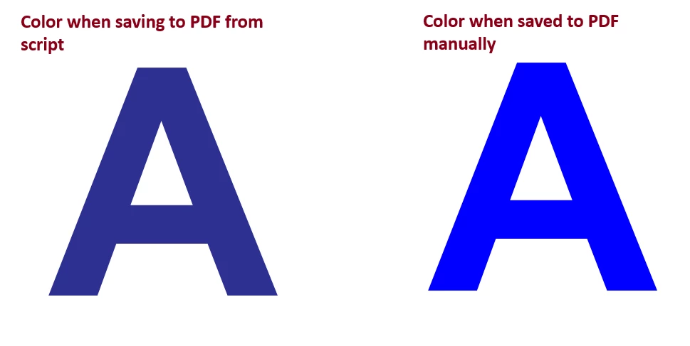

Hi, here you can see the difference in color. This happens for text front color.
So, if there is no problem with the script content, then it must be a bug in Framemaker and this feature does not work, right?
