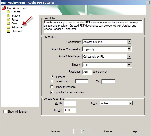

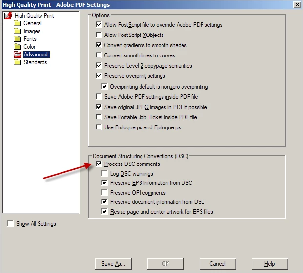

    I've found one reference online to an ioerror + pdfmark error that was related to the Document Structuring Conventions, so disabling DSC  might be worth a try; in years gone by DSC settings were a source of considerable distillation pain.
    I believe you said you have an Acrobat install and not just the one that comes with FM (??), I'm using Acrobat 9 so I don't know if the menu items will be the same in your Distiller or not, but open Distiller, go to Settings and then click on "Edit Adobe PDF settings.
    Question: What joboptions settings are you using -- High Quality Print or .... ??
    Then click on Settings and find the entry similar to "Edit Adobe PDF settings" which should bring up a dialog similar to this one below:
    Click on Advanced, and then check whether DSC is enabled
    assuming so, uncheck it. Then do OK, and when the Save dialog comes up save it as a new name (NoDSC.joboptions or whatever).
    Now try to create the .ps and pdf, being sure that the NoDSC joboptions are being used when you distill.
