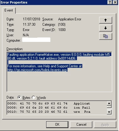

Faulting application FrameMaker.exe
We are getting the below error. Could you please let us know how to fix this.
Faulting application FrameMaker.exe, version 8.0.0.0, faulting module fsl5_80.dll, version 5.2.1.0, fault address 0x00114d06.
For more information, see Help and Support Center at http://go.microsoft.com/fwlink/events.asp.

I'd be highly doubtful that FM8 was intended to run on a Win 2003 server without violating the license agreement. If this was working for you before, what's changed? Is it throwing this Windows error with all docs or just one? What were you doing when it occurred?
